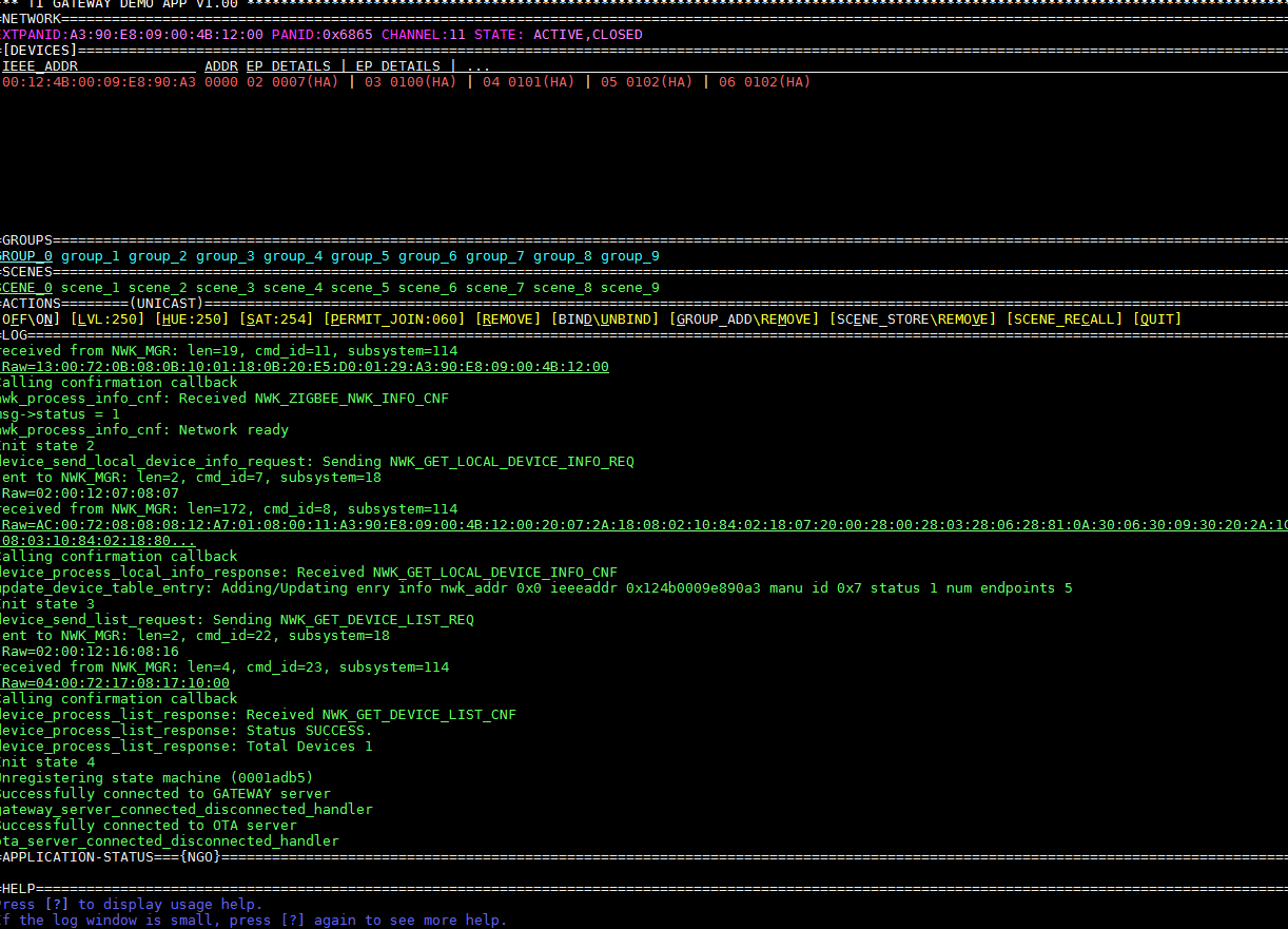

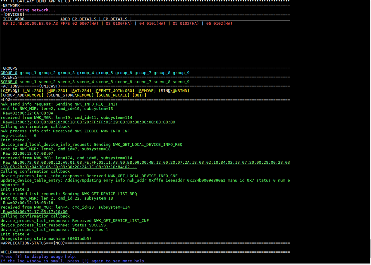

I have another question about ZNP. Can I use Z-Stack linux gateway with ZNP in this version? When I use ZNP no network is formed!
So is there no way to update Z-Stack home with Z-Stack 3.0??! I want to use feature of Aging Timeout in Z-Stack 3.0. I compared ZNP code of two versions and they are similar but some parts are added to ZStack 3.0 ZNP code.
Thank you Ryan. I hope new version of Gateway be available soon in order to use new features of Z-Stack 3.0. I wish I would able to use the current version of Z-stack GW with Z-Stack 3.0 until new version be available.
