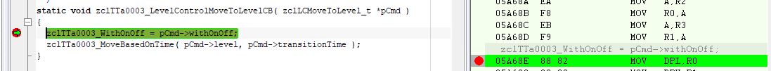

I working on my Dimmer device, based on HA simple light code, using Z-Stack Home 1.2.2a.44539 togther an commercial gateway.
I observed an unmoral behavior, after my device received ZCL Level Control: Move to Level with onoff with specif level, for example 255, 127 etc., my device didn't storage the level and report to gateway in response to ZCL Read Attribut (always Level 0x0000).
 I trying to identify each specific function on zcl_TTa0003.c file. is responsible to handle it, but i didn't identify.
Anybody can help me to understand it?

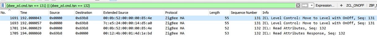

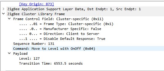

Level control sent by GTW with 127

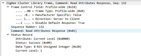

ZCL read attributes response message with Current Level: (0x0000)
  • Are you sure you read correct attribute?

    Mr Yk´s you where correctly, I said wrong information in my last post. The parameter correctly is current Level (with a decimal value). Sorry for that!

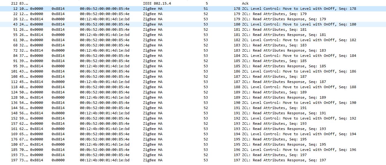

    The main problem is, the dimmer level same times not accepted changes, for example, If I moved it for 50% (127), how could I see in the message ZCL Level Control (level value 127), i tried to change a few times to another values, as I can see in the ZCL control Level, but this does not happen.
    In the sniffer attached, you can see the seq numbers from 178 to 197 some inconsistencies, do you not see in the file the 1st dimmer level settings, as I wrote bellow:
    seq. num. 192 - ZCL Level control sent by gtw (mac xx:4e) w/ level: 114
    seq num. 193 - ZCL read att response sent by My Dimmer (mac xx:bd) w/ current level: 114 - it´s ok.
    seq num. 194 - ZCL Level control sent by gtw (mac xx:4e) w/ level: 204
    seq num. 195 - ZCL read att response sent by My Dimmer (mac xx:bd) w/ current level: 114 - it´s wrong value.
    I debugged as Ryan advise me, and I saw that LevelControlMoveToLevelCB was achieved, as you in the PIC attached. But I can´t identify the exactly fail moment. I believe that we maybe we have problem in the zclTTa0003_MoveBasedOnRate. I include attache zcl_TTa0003.c file.
    Please, can you give me some tips to fix it?

    static void zclTTa0003_LevelControlMoveToLevelCB( zclLCMoveToLevel_t *pCmd )
      zclTTa0003_WithOnOff = pCmd->withOnOff;
      zclTTa0003_MoveBasedOnTime( pCmd->level, pCmd->transitionTime );

  • I suggest you to set breakpoint and check zclTTa0003_LevelCurrentLevel value when you do read attribute.
  • As already hinted, the LevelCurrentLevel value is not updated with NewLevel in AdjustLightLevel until LevelRemainingTime is completed, and if Rate32 is not fast enough then you could be trying to read the attribute before the level has properly changed. Try implementing a greater delay after moving levels.
    Ryan
  • Hi Mr Yikai and Ryan,
    I made some debugs and I saw that the function zclTTa0003_DefaultMove is not working well when transiction is greater than zero , after I changed transition time to 0 works wonderful.
    Right now my ZCL Level Control has a transition time as ZERO, as you can see bellow:
    I have problem now to reach the minimum and maximum values, I observed that the Min and Max levels on my code is different from ZCL Level control Payload on ZCL LEVEL CONTROL MESSAGE.
    I made changes in the code (zcl_TTa0003.c) but it still does not work.  They have any idea how to fix it?

  • According to ZCL spec, it has no effect when you set OnLevel to 0xFF
    3.10.2.2.4 OnLevel Attribute
    The OnLevel attribute determines the value that the CurrentLevel attribute is set to when the OnOff attribute of an On/Off cluster on the same endpoint is set to On. If the OnLevel attribute is not implemented, or is set to 0xff, it has no effect. For more details see 3.10.2.1.1.
  • Hi Mr Yikai,
    I understood exactly as you said. I´ll talk the incorrect behavior from commercial gateway!
    Thanks a lot for your assistance!
    Alex
