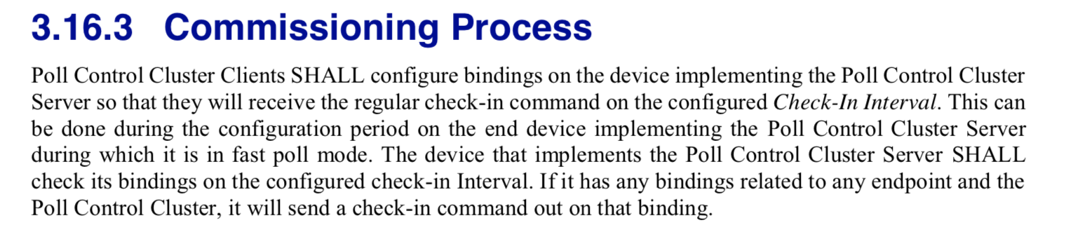

Thank you again YK Chen. From the specification I understand that ZED implements Poll Control Cluster Server and ZC implements Poll Control Client. But as shown in the sequence diagram below (from ZCL specification) ZED must send Check In command to ZC and it does it at an configured interval. Is the command sending from ZED to ZC done automatically by Z-Stack or the application must implement a timer routine to send this command?
Ok. Application layer must then implement a time routine to send check in commands to ZC periodically right? If so what must be the timeout value to use? Also the specification has some default attribute values for long and short poll interval what is the significance of this?
Yes, you have to create a periodic timer event to send check-in command to ZC. 3.16.4.2 Attribute Settings and Battery Life Considerations in ZCL spec already elaborate the significance of those default attribute values for long and short poll interval.
I read the commissioning process given in ZCL specification. I have the following questions. Apologies, if I'm asking the same questions again.
1. Long Poll Interval: The amount of time between MAC Data Requests when the device is in its normal op- erating state and not expecting any messages - ZED uses this interval to send data request after it receives a check-in response with start fast polling set to false?
2. Short Poll Interval: The amount of time between MAC Data Requests when the device is either expectingdata or has been put into “Fast Poll Mode” by the controlling device - ZED uses this interval to send data request after it receives a check-in response with start fast polling set to true?
3. Fast Poll Timeout -Time duration in which the ZED will remain in FastPoll mode where it sends data request using Short Poll Interval?

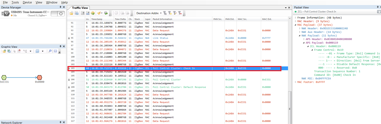

As per the specification I have set the POLL_RATE value in f8wConfig.cfg to a non zero number. My ZED and ZC are properly binded for Poll Control Cluster. I have set my Check-in interval as 180secs, Long Poll interval value to 30secs, and Short Poll interval as 5 seconds. If you see the log my check-in command are sent to ZC every 180 secs. But the Data Request are not sent to ZC in the configured interval.
After I send the checkin command I change the poll rate to my short interval value which 5 seconds. But I don't see this reflected in the log. What I observe is that data request is sent to ZC after check in command is sum of Long interval and short interval (35 secs).

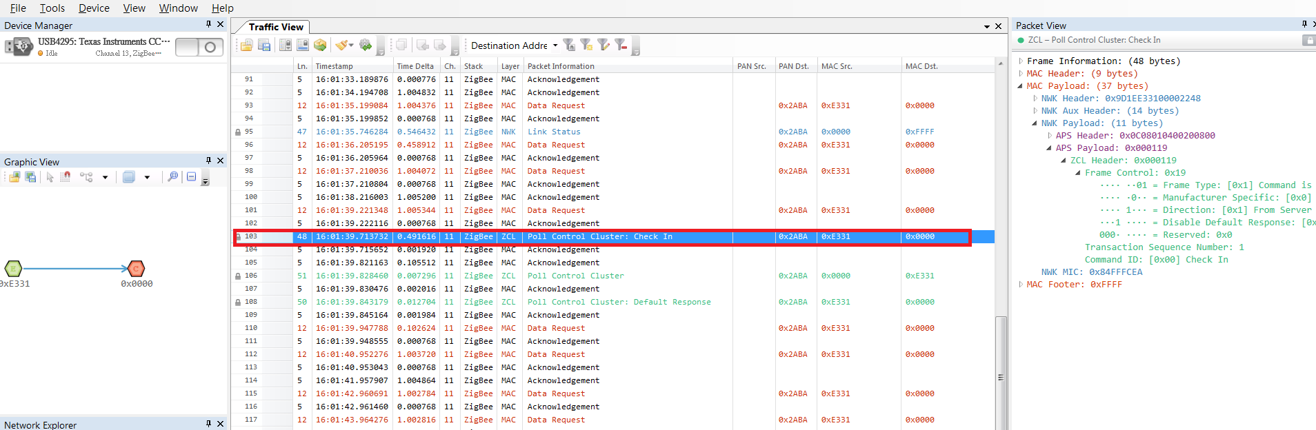

As I mentioned earlier I'm trying some negative test cases to test my application core logic. Today I found that without a bind request from ZC to ZED for poll control cluster the ZC was able to respond to a ZED checkin command. Attached the sniffer log for your reference.
