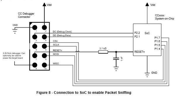

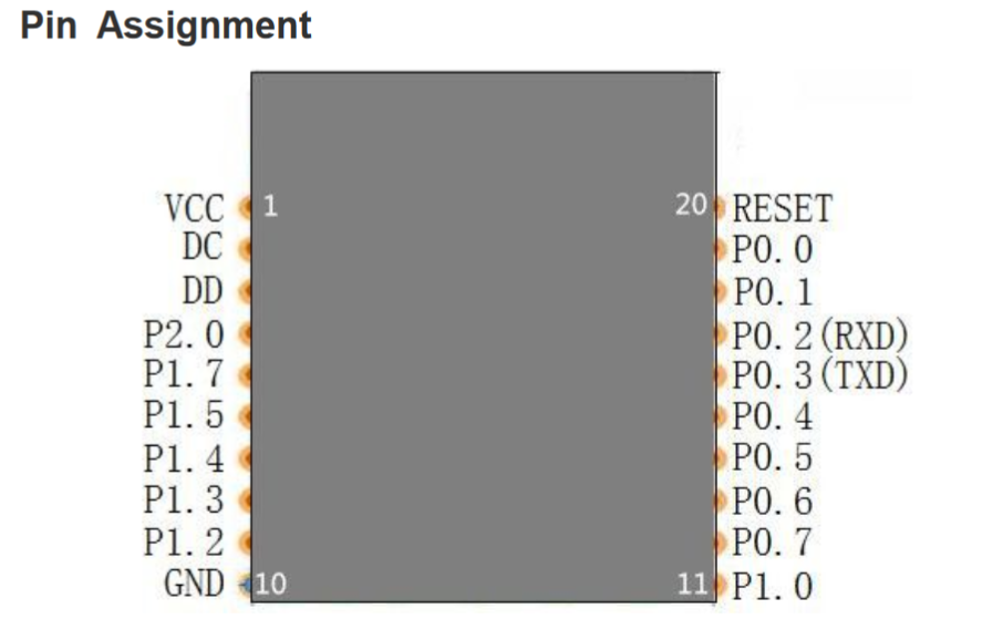

But I did not get the answer to the question of the connection for Packet Sniffer that CC2530 PA1 have not the pins P1.4 to P1.7 , and what should I see on file about pin out of IC ?
Still a bit lost on what you want to do but it looks like the UART is available together with the debugger interface. UART is typically used in applications like this to send data from the concentrator to a unit outside the network.
