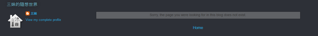

    I opened your link but ...
  • Are you from China?
  • I think it's blocked by Great Firewall..... Anyway, I attach the blog content in the followings:

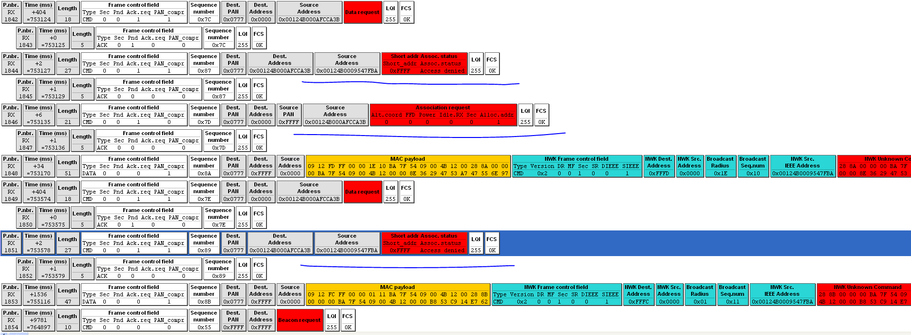

  • YK Chen Sir.
    Sorry for distube to you.
    I attached one image.
    Would you please explain to me "Blue underline"?
    Piao
  • You can use Ubiqua Protocol Analyzer to open sniffer log and it can be better parsed.
