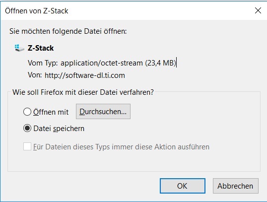

I downloaded the Z-Stack from TI, but my PC (win 10) is not able to recordnize the file-type, its just "File", no ending. I cant open it or do anything with it.
How can I make the downloaded thing work?
I hope so much some one is out there, smiling while remembering his/her first trials and can lead me a little.
  • It’s an exe file after you download and unzip Z-Stack. If not, can you show me what you downloaded?
  • Yes, i thought so, but the download is an octed-stream. Im not sure how to show you, I followed the instructions exactly from the link you provided. I tried to append the .zip ending by my self but it is still unzipable (and openable). Do I miss something?
    (For making sure: clicked the download-button under "buy from TI", confirmed that i dont do mad with it, and just downloaded)
    I dont want to harm the licence by just appending the file, or shell i?
    I mad a picture from the download-menu:
    EDIT: It is an unziped .exe. After appending the .exe it worked. So ty till now, please stay in touch this was not the end. I will mark this question as answered at the end, promissed!
