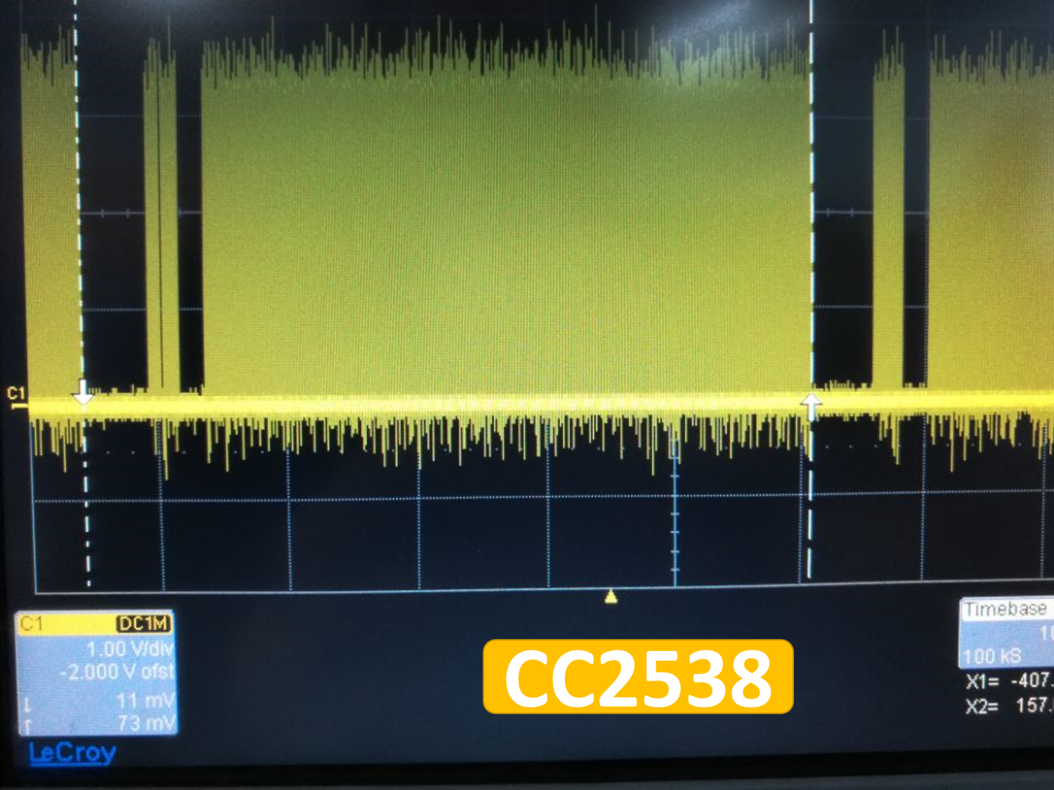

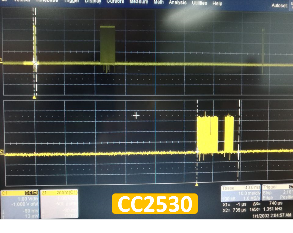

         Remove the RF testing instrument ( IQxel ), instead with CC2530 (module)or CC2538(module) to generate testing packet. Find out : the speed of  the module of CC2538 TX or RF Data is too slow, compare with CC2530. Further, we find that CC2538 use JTAG(2 wires)to connect with SmartRF Studio7. However,  CC2530 use special debug interface (2 wires, P2.1/P2.2)to connect with SmartRF Studio7。For the same data packets, the different interface leads to different speed, the following pictures are their waves.

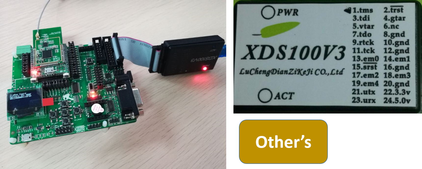

  • Hi,RGW:
           I have tested four ours CC2538 modules and two third CC2538 EM, their picture is following:
          We have no TI CC2538 EM, so we haven't tested it.
           I suspect strongly that the two wires JTAG interface protocol leads to the issue, for above wave picture (via oscilloscope) and the following test data(Magbe we should change the parameters of  SmartRF studio, or use other interface (e.g UART) ,but we don't know how do it. ):
