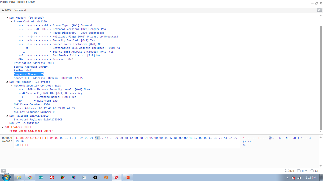

why there is no provision of encryption of Nwk header and Nwk aux header in zigbee packet??
The Network Security Level is set to 5 which corresponds to a 32 - bit MIC. As per the Zigbee Specification, the Security Level is cleared after encryption of the payload and transmitted over the air. While decrypting the packet, the Security Level is set to 5 (in the decryption nonce as well).
1) does anyone tried adding mac layer encryption before?
2) As per current discussion NWK aux header is not encrypted.
But In my other post JasonB had mentioned that "NWK frame counter value is encrypted"
the NWK frame counter is part of NWK aux header then how can it be encrypted?
