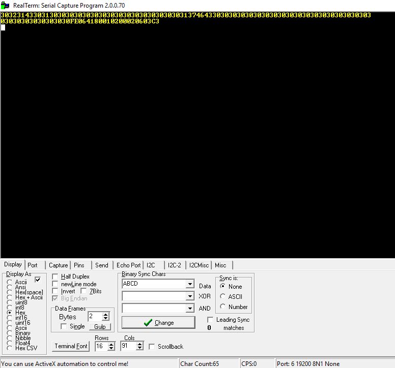

My new function that is not working well:
* @fn zclTTa0003_UartSEND
void uart0Send(uint8* uartTxBuffer, uint16 uartTxBufLength)
// Clear any pending TX interrupt request (set U0CSR.TX_BYTE = 0).
U0CSR |= 0x80;
// Loop: send each UART0 sample on the UART0 TX line.
for (uartTxIndex = 0; uartTxIndex < uartTxBufLength; uartTxIndex++)
U0DBUF = uartTxBuffer[uartTxIndex];
while(! (U0CSR & 0x80) );
U0CSR &= ~0x80;
My new function called in on/off CMD:
if ( cmd == COMMAND_ON )
zclTTa0003_OnOff = LIGHT_ON;
#ifdef ZCL_MONITOR
//Output "UART debug output" to UART Port0
HalUARTWrite( HAL_UART_PORT_0, "Light is ON", (byte)osal_strlen("Light is ON"));
#endif
// Turn off the light Written ASA
else if ( cmd == COMMAND_OFF )
zclTTa0003_OnOff = LIGHT_OFF;
#ifdef ZCL_MONITOR
uart0Send(uartTxBuffer, SIZE_OF_UART_TX_BUFFER);
#endif

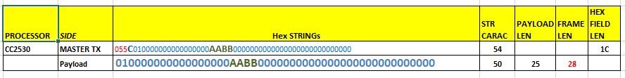

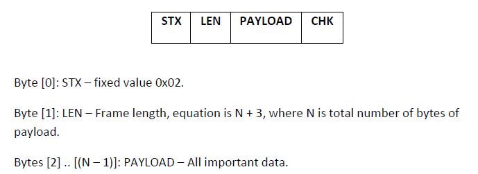

The existent protocol have follow structure:
My dimmer (Master):
Exchange device (Slave):
Frame Format Structure:
The word sent by Master (my dimmer device):
When: AABB is a Duty Cycle value to setup the PWM Level in a exchange board.

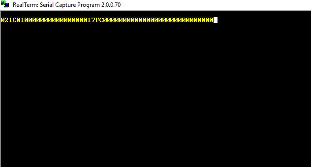

I have in my mind to cut the word in 2 parts, 1st 055C010000000000000000, 2st AABB0000000000000000000000000000 and handling duty cycle in the 2st part. After it to merge in a function to send a complete word.
I need to build a SEND UART function, to send the word. I study UART Hal API and Didn´t find anything command to do that.
Before to send a HEX values in a new function I starting to test with string text, but i is not working, when my device call this new function stop to work.
Anybody have an idea how to build a function to send the word above?
