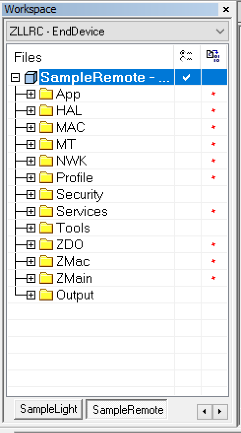

  • In the Z-Stack Lighting Developer's Guide, Section 4.2 Optional Compilation Flags, it notes:
    • POWER_SAVING – enables an end-device to sleep and conserve power, when inactive. Should be defined on any battery-powered device.
    • POLL_RATE=0 – override the default poll rate of polling end-devices, allowing them to sleep until wakened by an external event, e.g. user key press on a controller board.
    • ISR_KEYINTERRUPT – set the device to rely on key interrupts instead of polling for key inputs, allowing to fall to deep-sleep (PM3) if defined on end-device with POWER_SAVING and POLL_RATE=0.
    In the ZLLRC - EndDevice configuration, these are set. However, they are not set for the configuration EB - EndDevice. In IAR, please ensure that the example you built was for the SampleRemote and that you configuration set to build was ZLLRC - EndDevice, as shown in the image below: (If you wish to have no polls after commissioning)
    EDIT: Is your end goal to poll after commissioning, or to not poll? The above compilation flags are for you to be able to get your desired effects. From your post above, since you used the EB configuration, it is expected to see polling after commissioning because of the compilation flags.
