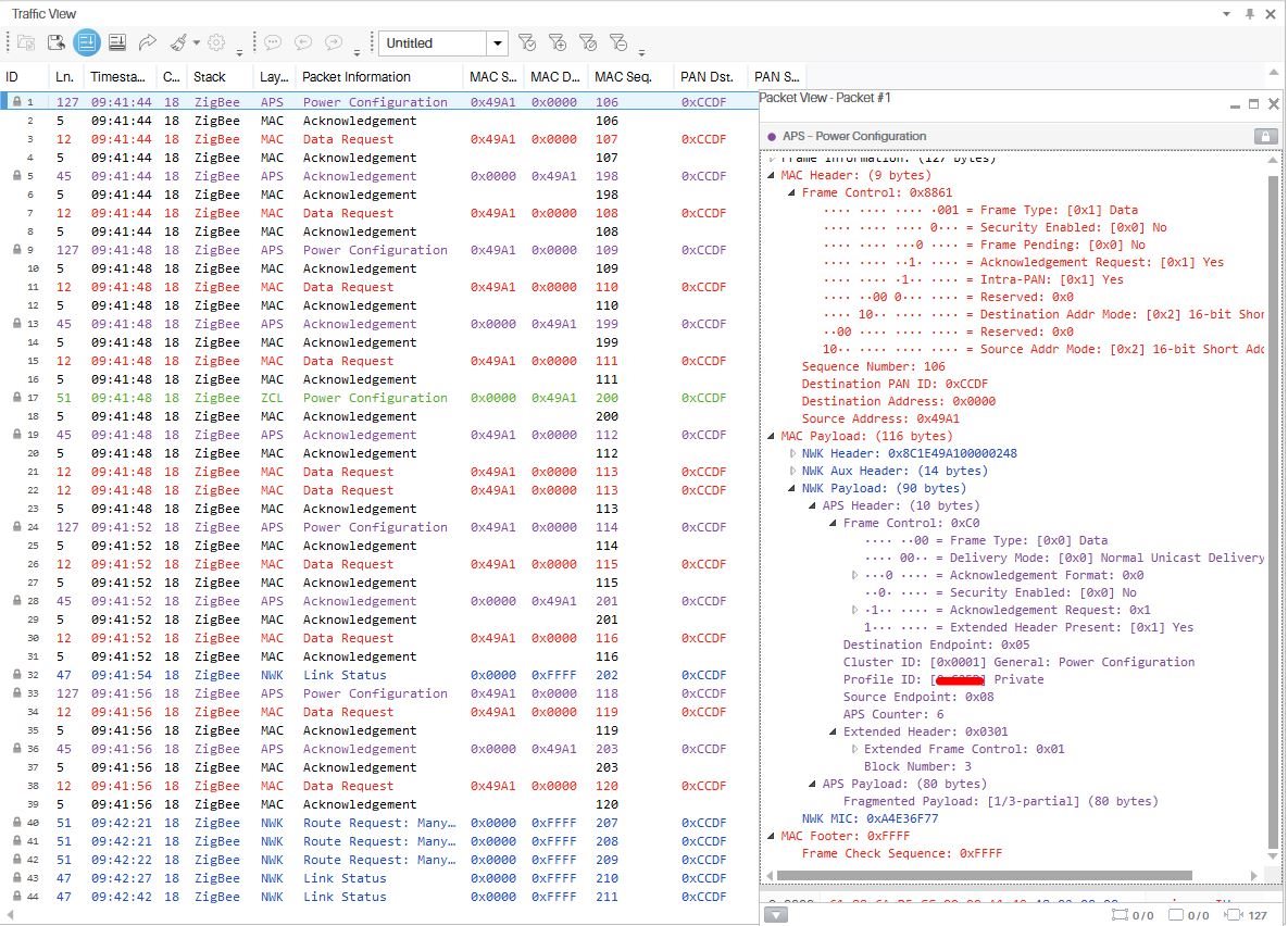

  • I tested unicast to ZC which works now but I tried the same thing with sending a report using zcl_SendReportCmd() which doesn't work.
    status returns ZSuccess.
    I'm trying report to these 2 addresses
    DstAddr1.addrMode = (afAddrMode_t)Addr16Bit;
    DstAddr1.endPoint = 0x5;
    DstAddr1.addr.shortAddr = 0x0000;
    DstAddr2.addrMode = (afAddrMode_t)AddrBroadcast;
    DstAddr2.endPoint = 0x5;
    DstAddr2.addr.shortAddr = 0xFFFC;
    but the image is only for DstAddr1
    It says the payload is fragmented but I never get payload 2/3 or 3/3
  • Try to use "DstAddr2.addr.shortAddr = 0xFFFF;" instead of "DstAddr2.addr.shortAddr = 0xFFFC;" when doing broadcast.
  • sending with broadcast returns 0x02 from here:
        if (len > afDataReqMTU( &mtu ) )
          if (apsfSendFragmented)
            stat = (*apsfSendFragmented)( &req );
    EDIT: I have 15 attributes to report and I've just tested with 3 attributes and it works fine. testing with 7 attributes showed 1/2 payloads but never sent payload 2/2 so I think its the fragmentation

    I noticed that for some reason, in the packets received the productString and firmwareVersion are joined together under the firmwareVersion attribute id.
    so I get something like :
    PACKET 0xfirmwareVersionID:
    data type = 0x42
    length = 49
    data = ".0.0              .product_string-BEN"
    and apparently the datalength for the productString is 107 and the firmwareVersion is  53 .

  • fragmentation only support up to 2 fragments so It should be OK to send up to about 160 bytes in single zcl_SendReportCmd .
  • when the message is fragmented, the application doesn't send the second part of the message.
    also two different attributes are getting reported as one as I stated above. this happens even if I only report one of those two attributes.
    how long do I need to wait between calls to sendreportcmd?
  • I would suggest to have 100ms between ZCL send report.
