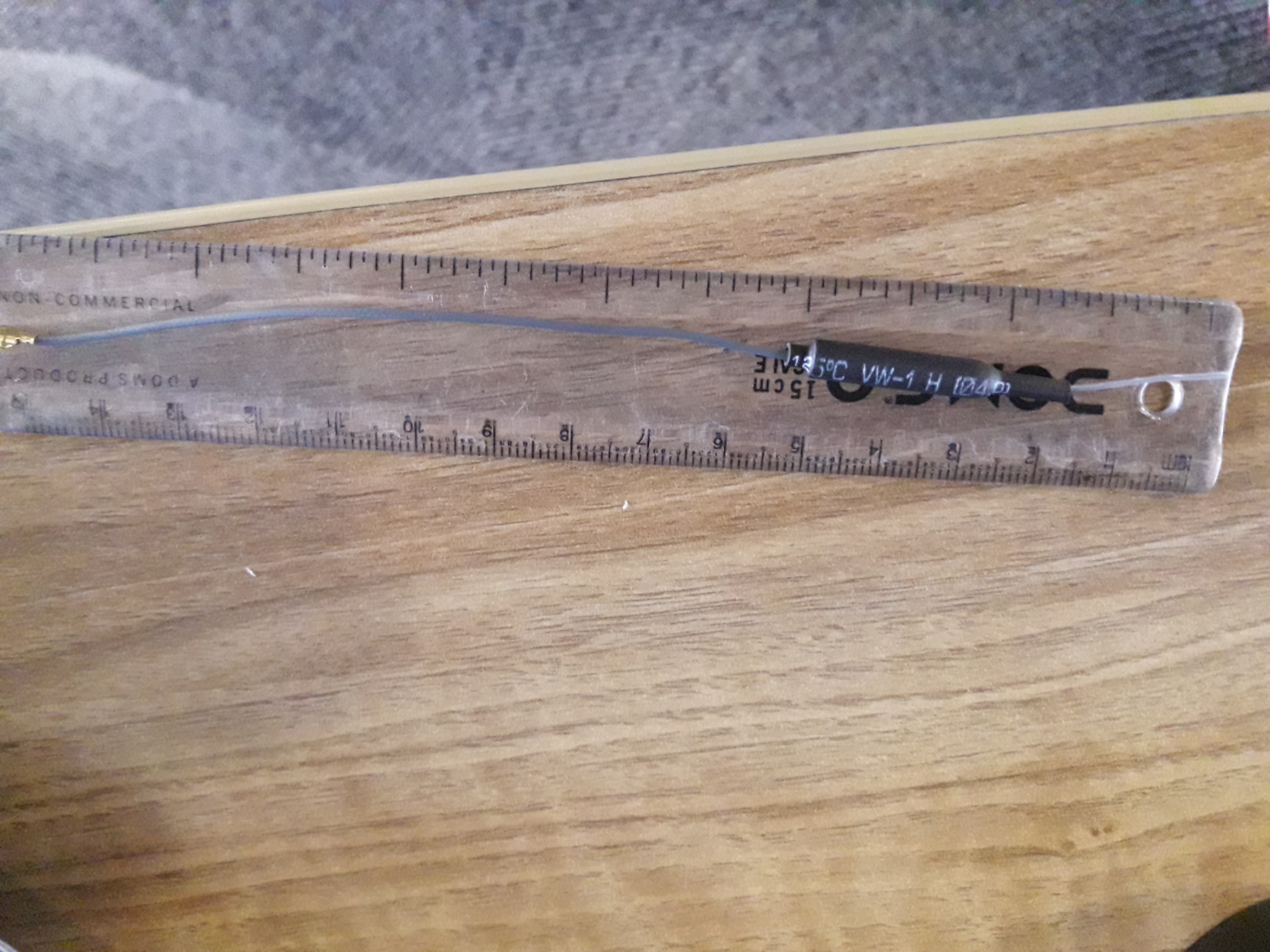

  • It is possible problem in Antenna, I set different value using ZMacSetTransmitPower() function , RSSI value increase and decrease ,but no difference in range
  • Maybe. I suggest you to use Flash Programmer 2 to do PER test first.
  •  Can you verify  antenna , I have attached picture, it's 15 cm long
  • I cannot verify antenna by a picture.
  • Yes, the schematic is all connected properly it appears. I would imagine it is probably something to do with the antenna, however, I cannot confirm from the picture.
