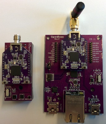

I'd like to know the power consumption of my cc2538 running a CoAP server taken from cetic/6lbr repo (a Contiki OS branch).
The mote is attached to the TI SmartRF06  (the open-base on the right)
and the base is connected through usb cable (attached to my mac) in the usb 3.0 port.

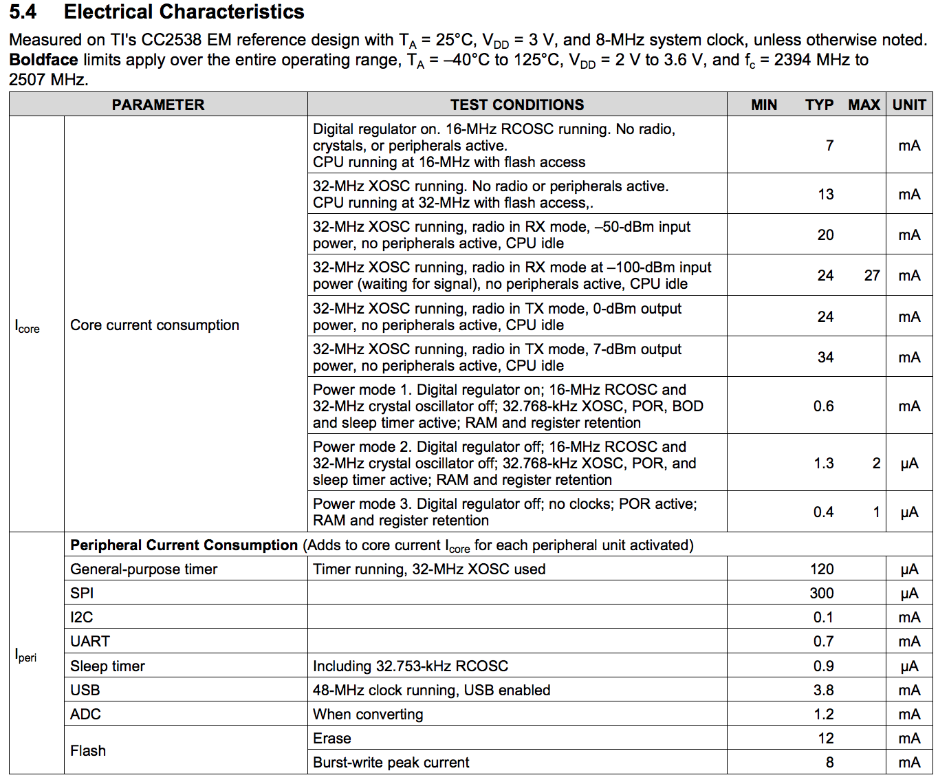

For the total energy there's a formula which requires Voltage and the current of all 4 components (CPU,LPM,TX,RX).
I've checked the cc2538 datasheet
http://www.ti.com/lit/ds/symlink/cc2538.pdf
and from what I get the RX current is 20mA, and the TX current is 24mA. What about CPU and LPM?
