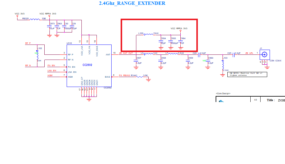

Hi Support Team,
We are using CC2592 Range Extender with CC2530 zigbee chip. Here I attached the schematic of RF path.
We are using UFL connector. The antenna part is SWA028W: Internal 2G / 5G Dual Band Wi-Fi FPC Antenna. This is passive antenna we are not using SMA.
So the component which are highlighted with RED block is necessary for the design. My understanding is it is for active antenna.
Question 1: Highlighted component is require for the design.
Question 2: If requirement then please explain for my knowledge.
Thanks.
