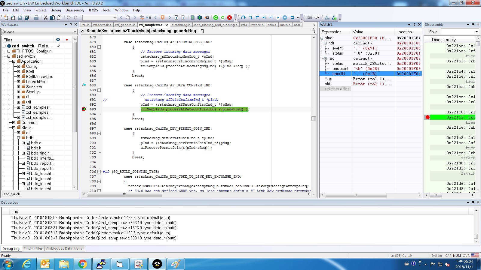

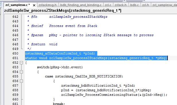

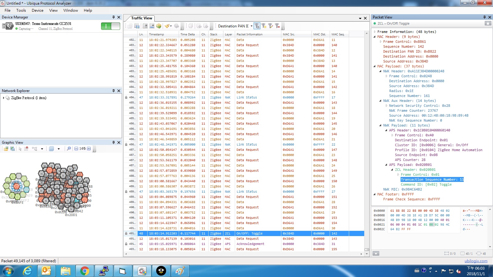

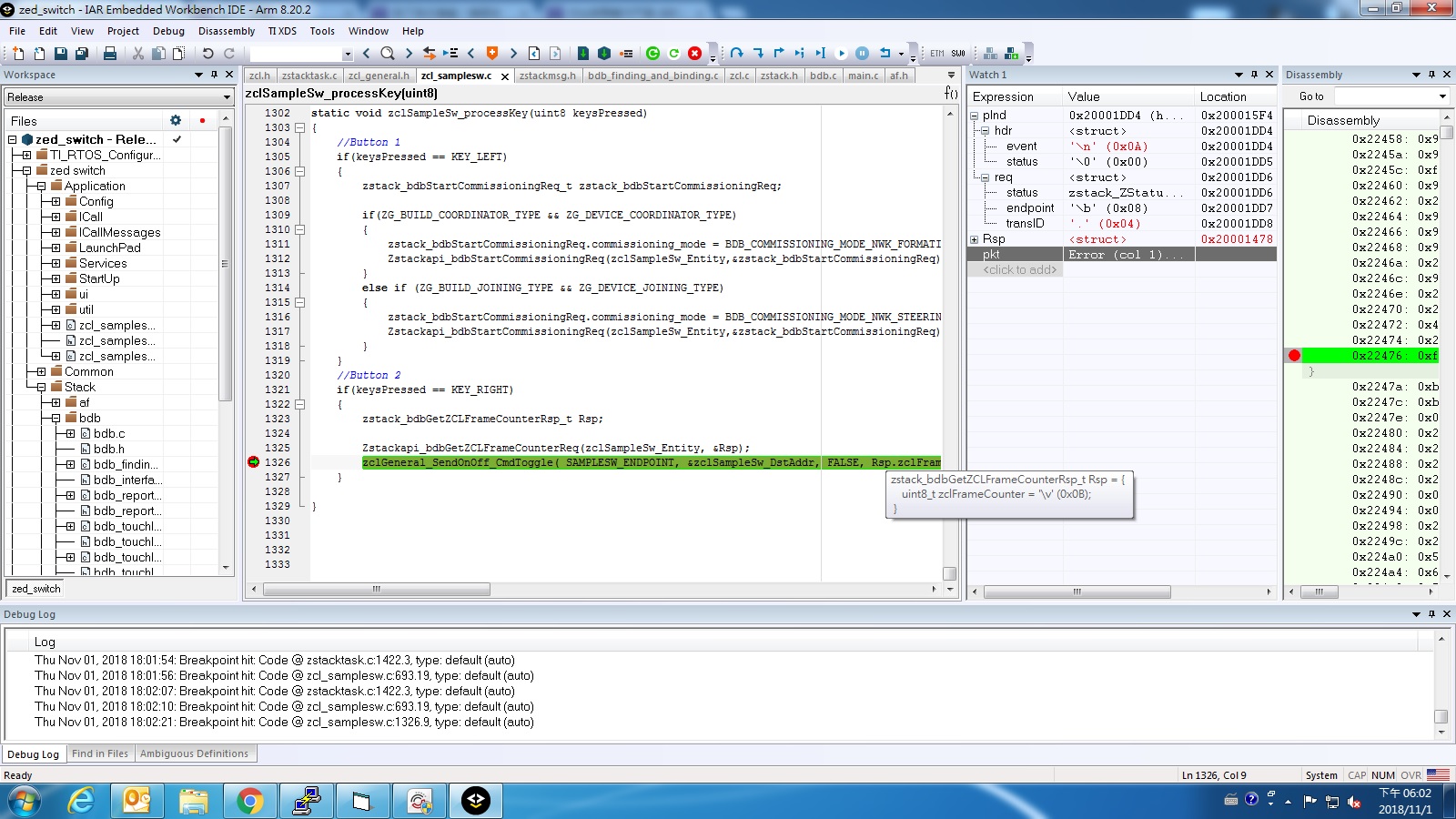

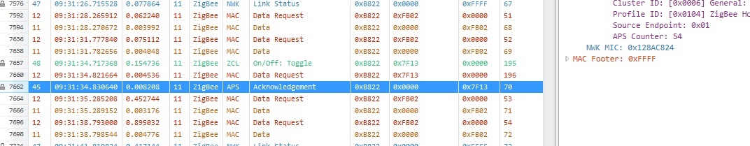

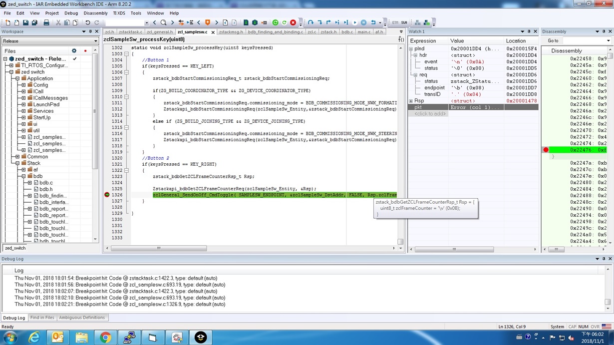

Hi all,
We edit "zed_switch" and try to get APS ack when device send toggle command. We can get sequence umber when sending command(0x0B, we also get this number from sniffer). But, transaction ID is different when we get APS ACK. Do we miss something?
SDK : simplelink_cc13x2_sdk_2_30_00_45
pic.1 send toggle
pic.2 sniffer
pic.3 APS ack

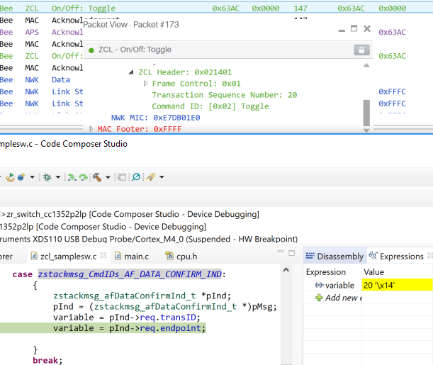

  • Hi Kimi,
    I was not able to replicate the issue, the operation is as expected on my setup with the same SDK version.  Where do you define the pInd pointer as type zstackmsg_afDataConfirmInd_t if not in zstackmsg_CmdIDs_AF_DATA_CONFIRM_IND?
    Regards, Ryan

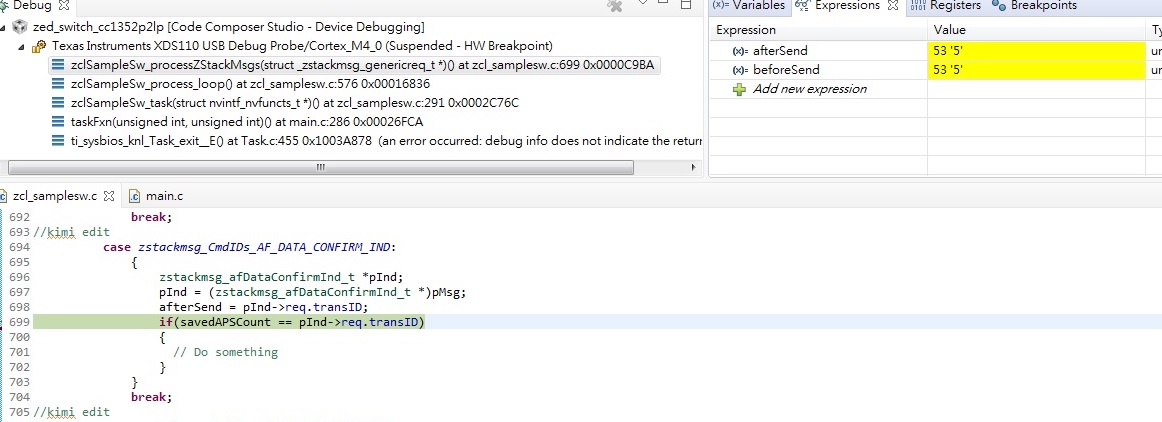

  • In zstackmsg_afDataConfirmInd_t, we only have req.transID and it doesn’t match zclFrameCounter that we set in zcl send command. How do we check the APS ack is from my specific zcl send command?

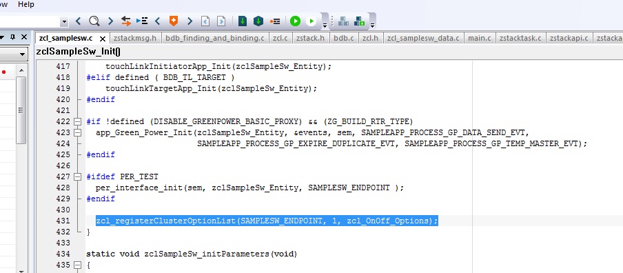

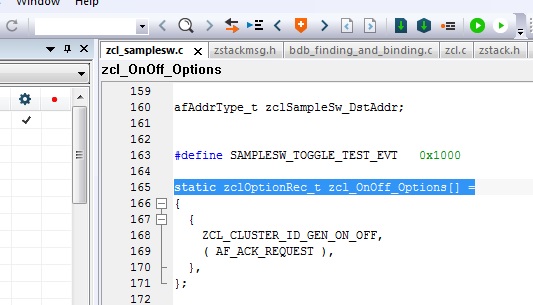

  • Hi Ryan,
    The definition is showing pic.1.
    I add zcl_OnOff_Options(pic.2) and register it in the end of the zclSampleSw_Init(pic.3). Do I miss something? Thanks
    pic.1
    pic.2
    pic.3
  • I moved my pInd initialization to the same location as yourself and still got matching sequence numbers. Are there any other changes to the example and can you provide the sniffer log? It is worth noting however that zstackmsg_CmdIDs_AF_DATA_CONFIRM_IND occurs due to the On/Off Default Response (enabled when the disableDefaultRsp parameter of zclGeneral_SendOnOff_CmdToggle is set to FALSE), not the APS ACK  either when the stack generates an AF data confirm for a frame (for frames that don't use APS ACK) or specifically only if an APS ACK indication arrives (if APS ACK is enabled). When comparing packets you may notice that the transaction sequence number is only present on the former instead of the latter. APS ACKs can be checked through AF_DATA_CONFIRM_CMD with timeout logic to check for a valid response.
    Ryan

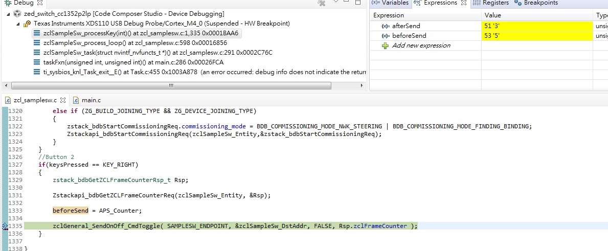

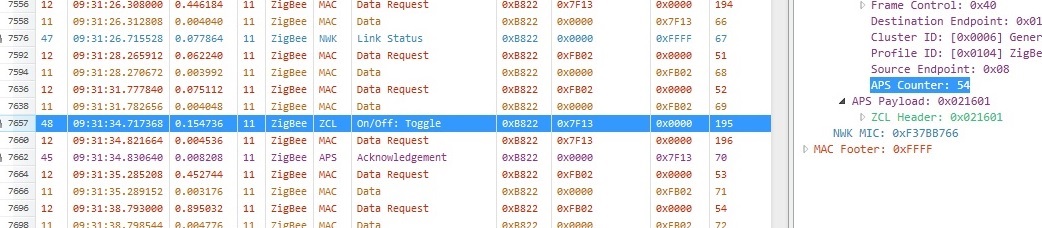

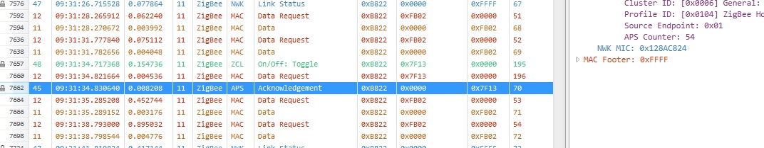

  • Hi Ryan,
    I have two questions :
    Q1. Even follow your description, I cannot receive correct transID(it does not match with sequence number )
    Q2. My purpose is receive APS ACK in the Stack. How do I get APS_ACK packet(which callback) in the Stack?
    my file and sniffer are showing below(search "kimi edit")

    //kimi edit
     zcl_registerClusterOptionList(SAMPLESW_ENDPOINT, 1, zcl_OnOff_Options);
    //kimi edit

    //kimi edit
              case zstackmsg_CmdIDs_AF_DATA_CONFIRM_IND:
                      zstackmsg_afDataConfirmInd_t *pInd;
                      pInd = (zstackmsg_afDataConfirmInd_t *)pMsg;
                      test1 = pInd->req.transID;
                      test1 = pInd->req.endpoint;
                  break;
    //kimi edit

              case zstackmsg_CmdIDs_BDB_TC_LINK_KEY_EXCHANGE_NOTIFICATION_IND:
    //kimi edit
    //          case zstackmsg_CmdIDs_AF_DATA_CONFIRM_IND:

    void zclSampleSw_UiActionToggleLight(uint16 keys)
      if (zclSampleSw_OnOffSwitchActions == ON_OFF_SWITCH_ACTIONS_TOGGLE)
        if (keys & UI_KEY_SW_5_PRESSED)
          zstack_bdbGetZCLFrameCounterRsp_t Rsp;
          Zstackapi_bdbGetZCLFrameCounterReq(zclSampleSw_Entity, &Rsp);
          zclGeneral_SendOnOff_CmdToggle( SAMPLESW_ENDPOINT, &zclSampleSw_DstAddr, FALSE, Rsp.zclFrameCounter );

        if(keysPressed == KEY_RIGHT)
    20181105_PANID_B822.zip
  • Hi Kimi,
    I'm observing a similar issue when using IAR regardless of C/C++ optimization settings, I will pass this information along to the Software Development Team. Can you evaluate the solution on CCS and confirm that the issue is not apparent on this IDE?
    Ryan
  • Kimi will do the same test with CCS and reply the result to you. How about another question "Q2. My purpose is receive APS ACK in the Stack. How do I get APS_ACK packet(which callback) in the Stack?" According to your description "zstackmsg_CmdIDs_AF_DATA_CONFIRM_IND occurs due to the On/Off Default Response (enabled when the disableDefaultRsp parameter of zclGeneral_SendOnOff_CmdToggle is set to FALSE), not the APS ACK",  zstackmsg_CmdIDs_AF_DATA_CONFIRM_IND doesn't mean to get APS ack so please elaborate how application code can get and parse APS ACK after sending AF_DataRequest.
  • Hi Ryan,
    Actually, the last test is using CCS. I upload the test video for your reference(include sniffer and file)
    20181106_PANID_B822_CCS.zip

    //kimi edit
                      test2 = pInd->req.transID;
                      test2 = pInd->req.endpoint;
                  break;
    //kimi edit
      else
        // Other zclSampleSw_OnOffSwitchActions are not supported by this UI
    void zclSampleSw_UiRefresh(uint8 gui_state, char * line[3])
      line[2] = "< TOGGLE LIGHT >";
     * @fn      zclSampleSw_changeKeyCallback
     * @brief   Key event handler function
     * @param   keysPressed - ignored
     * @return  none
    static void zclSampleSw_changeKeyCallback(uint8_t keysPressed)
        keys = keysPressed;
        events |= SAMPLEAPP_KEY_EVT;
        // Wake up the application thread when it waits for clock event
        Semaphore_post(sem);
    static void zclSampleSw_processKey(uint8 keysPressed)
        static uint8_t test1 = 0;
        //Button 1
        if(keysPressed == KEY_LEFT)
            zstack_bdbStartCommissioningReq_t zstack_bdbStartCommissioningReq;
            if(ZG_BUILD_COORDINATOR_TYPE && ZG_DEVICE_COORDINATOR_TYPE)
                zstack_bdbStartCommissioningReq.commissioning_mode = BDB_COMMISSIONING_MODE_NWK_FORMATION | BDB_COMMISSIONING_MODE_NWK_STEERING | BDB_COMMISSIONING_MODE_FINDING_BINDING;
                Zstackapi_bdbStartCommissioningReq(zclSampleSw_Entity,&zstack_bdbStartCommissioningReq);
            else if (ZG_BUILD_JOINING_TYPE && ZG_DEVICE_JOINING_TYPE)
                zstack_bdbStartCommissioningReq.commissioning_mode = BDB_COMMISSIONING_MODE_NWK_STEERING | BDB_COMMISSIONING_MODE_FINDING_BINDING;
        //Button 2
            test1 = Rsp.zclFrameCounter;
  • Hi Kimi,
    This sequence numbers are not the same stuff zclFrameCounter is the transaction sequence number of the ZCL header and in other hand transID on data confirm is the APS counter of the APS header. From your capture you can look at toggle command at packet 417 and APS ACK at packet 421, and both of them have APS counter value in the APS header equal to 13 which correct and this is the value that transID holds.
    I hope this helps.
  • Actually, we are totally confused by Ryan's and your descriptions. Let's come back to our original request. We just need to check if we get APS ack after we send a ZCL command so can you elaborate with code to show us how to do that?
  • Hi YK,
    Are you not able to get APS ACK?
    step 1: have an options struct
    static zclOptionRec_t zclOptions[] =
    ZCL_CLUSTER_ID_GEN_ON_OFF,
    ( AF_ACK_REQUEST ),
    step 2: Register cluster options with zcl_registerClusterOptionList(SAMPLESW_ENDPOINT,1,zclOptions);
    step 3: On each APS ACK you will receive a confirm that is processed by processAfDataConfirm() and sends a message to application with zstackmsg_CmdIDs_AF_DATA_CONFIRM_IND. You can implement your function to process the data confirm.
  • If you read Ryan's previous reply, he said zstackmsg_CmdIDs_AF_DATA_CONFIRM_IND doen't mean APS ack. So, whose reply is true? If you are correct and we can process APS ack in zstackmsg_CmdIDs_AF_DATA_CONFIRM_IND, how can we match transID to the whatever (seqNum or APS_Counter) we send with zcl command?
  • Hi Jose Maria Alvarez,
    Please check my video(I have another reply with new sniffer and video). You can see in last toggle command. The APS_Counter in sniffer is 29 but I get transID in "case zstackmsg_CmdIDs_DEV_PERMIT_JOIN_IND" is 28
  • and Can you elaborate how we check APS ack after we send a zcl command?
  • Hi Kimi, YK,
    I apologize for the confusion I caused with my previous statement, it has since been edited and Jose will provide a thorough explanation and code example shortly.
    Ryan
  • Hi guys,
    One again we need to be clear that ZCL frame counter and APS transaction ID are not the same. In the current implementation you need to have track of APS_Counter before you send an APS layer frame like ZDO or ZCL command in order to validate with a zstackmsg_CmdIDs_AF_DATA_CONFIRM_IND message on application. All APS layer commands will generate an AF data confirm but the difference between using APS ACK flag is that with APS ACK enabled frames you will get an zstackmsg_CmdIDs_AF_DATA_CONFIRM_IND only when the APS ACK indication arrives, otherwise of APS ACK flag is disabled you will get an zstackmsg_CmdIDs_AF_DATA_CONFIRM_IND whenever the stack sends out an APS layer frame successfully.
    I used the next example on zcl_samplesw application to validate:
    - Add a zcl options struct
      ( AF_ACK_REQUEST ),
    - add a global variable to save APS counter
    uint8 savedAPSCount;
    - register cluster options in zclSampleSw_Init()
    - Save aps counter before sending the toggle command
    savedAPSCount = APS_Counter;  // Save counter
    - Add zstackmsg_CmdIDs_AF_DATA_CONFIRM_IND processing to zclSampleSw_processZStackMsgs()
      zstackmsg_afDataConfirmInd_t *pInd =
      (zstackmsg_afDataConfirmInd_t *) pMsg;
      if(savedAPSCount == pInd->req.transID)
        // Do something
    break;
    You can implement your handler for zstackmsg_CmdIDs_AF_DATA_CONFIRM_IND according to your application needs. Please try it like that and tell me if you need something else to be clarified.
  • Hi Jose,
    I follow your example. I can get the same APS_Counter(53) but I see another problem. The APS_Counter does not match the sniffer(54). Do I miss anything?
    pic.1 before send
    pic.2 after send
    pic.3 toggle command
    pic.4 APS ACK
  • Can you do the same test and show us your sniffer screenshot that APS_counter in sniffer is matched to savedAPSCount in your code?
  • This is perfectly fine because the spec doesn't specify and mandate this values to be equal since Zigbee spec only care about for Over-The-Air frames and the spec only mandates this counters to be incremental not sequential.
    This behavior is not an issue.
  • Don’t you think such behavior is confusing even you don’t think it’s an issue?
  • No, because as I said this values have no relation according to the spec, so completely different values can be used.
  • When I see something that is set in my code but not matching with sniffer, I am worried about it and that’s why I ask this transID thing in Z-Stack 3.0.x and also here. I still don’t think this is a good practice to see different APS_count in application and sniffer.
