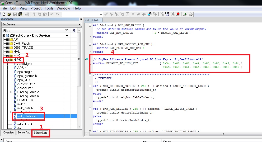

I am using Wireshark&TiWsPc and Wireshark&KillerBee to sniff ZigBee frames so in this scenario;
I need to understand
1-how the sniffers get Network Key (and-or also who),
2-how the sniffer decrypt the frames? Or 2-Who decrypts frames?
There are BBB as the gateway(Linux gw home design),cc2650 as sensor tag in my ZigBee network topology.
3-Which of these models(Distributed Security Model, Centralized Security Model) does have my network?
