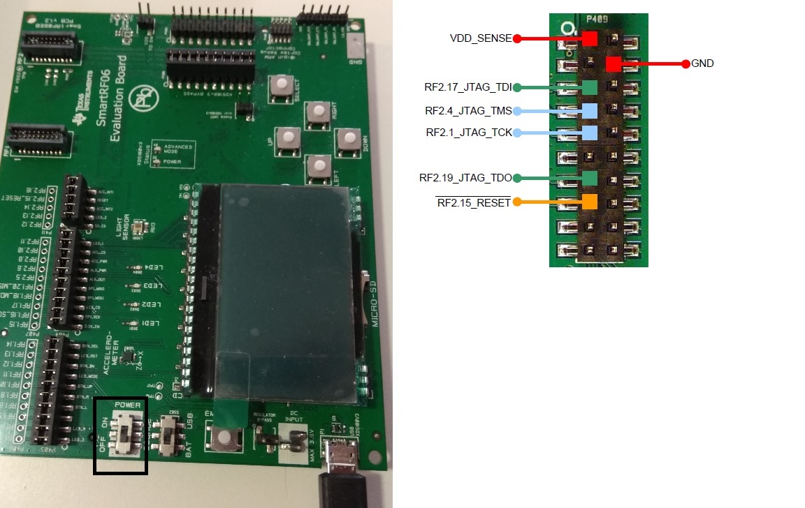

I'm using the SmartRF06 (EVM) to program an external target (CC2538NF23).
Jumpers and JTAG pins are connected according to document swru321b.
I programmed the flash memory succesfully and the program runs (a simple blink on a GPIO pin) but when i disconnect the power of the EVM the program stops working although they still have power supply (all this with the JTAG wire connected to the PCB where i have the CC2538). The program starts working again if i connect the EMV board and i open the program SmartRF Flash Programmer 2 (advance mode LED of the board turns on).
Moreover if i only disconnect the JTAG header the program keeps running until it is reset or the power supply is shut down.
i don't know why is only working when i have the EVM connected. Advance Mode is doing something in the bootloader? The problem could be in the memory mapping?
Anyone has a clue of what is happening?
