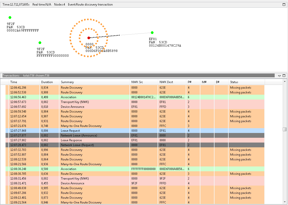

HI,
I'm facing the problem that after I receive a Leave Indication on my SED I want to do a system reset and delete all NWK information. Unfortunately when I then proceed to join the same network again my device has the IEEE address of 0xFFFFFFFF00000000. I attached a sniffer log of this process. Here is the code snippet of the leave process:

This is not the behavior I need. Is my Reset Request incorrect or why is the IEEE address changing?
