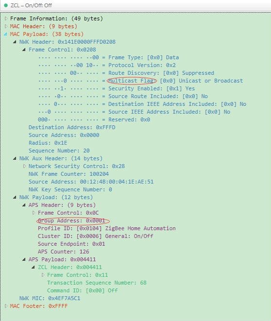

When we make the group control, we found the muticast flag is always 0, not 1.  Any setting for this flag in Z-Stack?  We use the stack Z-Stack Lighting 1.0.2.
