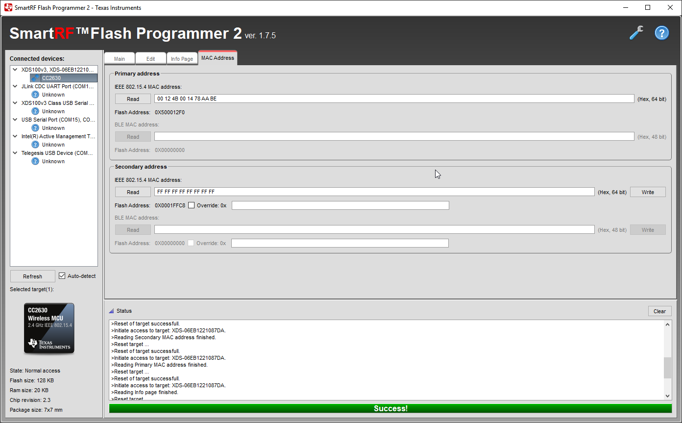

    Thank you for your reply:
    we've tried a few things:
    using memcpy(user0Cfg.extendedAddress,(uint8_t *)&(__ccfg.CCFG_IEEE_MAC_0), ZSTACKCONFIG_EXT_ADDR_LEN);
    = 0xFF FF FF FF -> which makes totally sense, cause we don't programm it.
    reading out:
    memcpy(user0Cfg.extendedAddress,(uint8_t *)(FCFG1_BASE + EXTADDR_OFFSET), ZSTACKCONFIG_EXT_ADDR_LEN);
    copies the IEEE address in user0CFg. which is in our case: 00124B001478AABE (see screenshot)

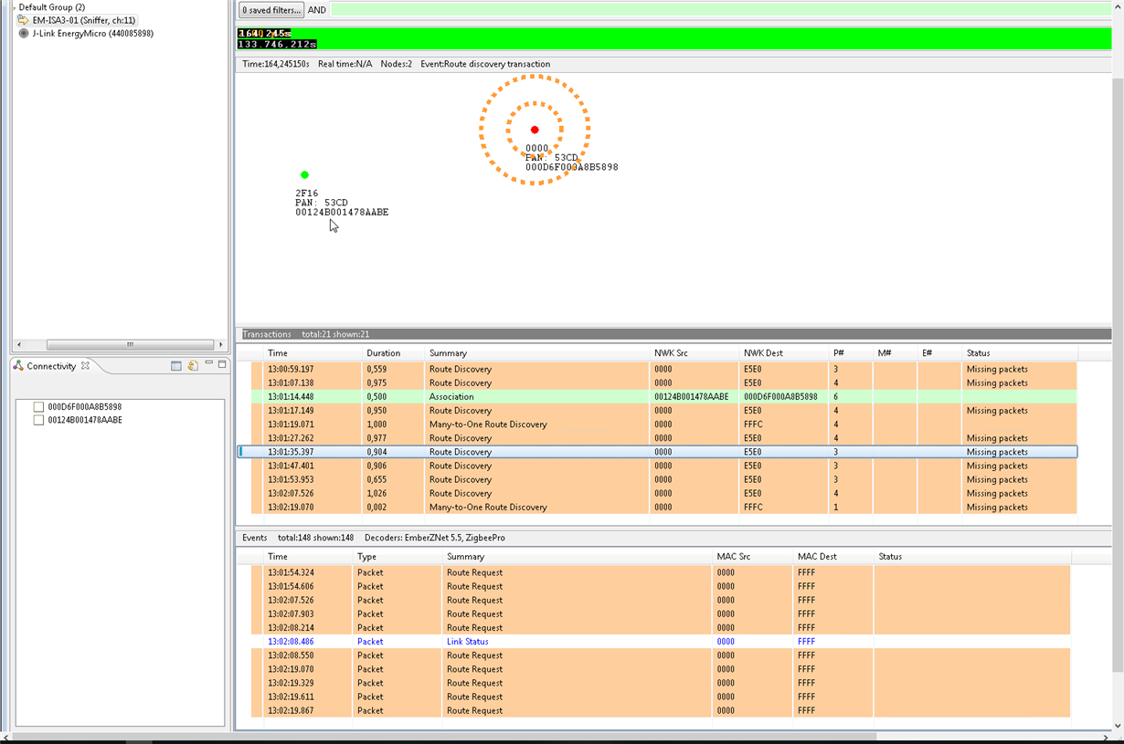

    now the strange parts:

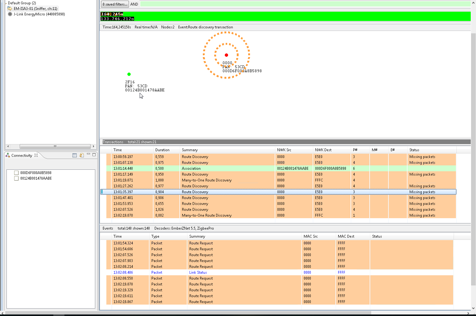

    when we erase the chip and start zigbee pairing for the first time then we can see that our node starts with the address 00124B001478AABE  as assumed. (see screenshot below)

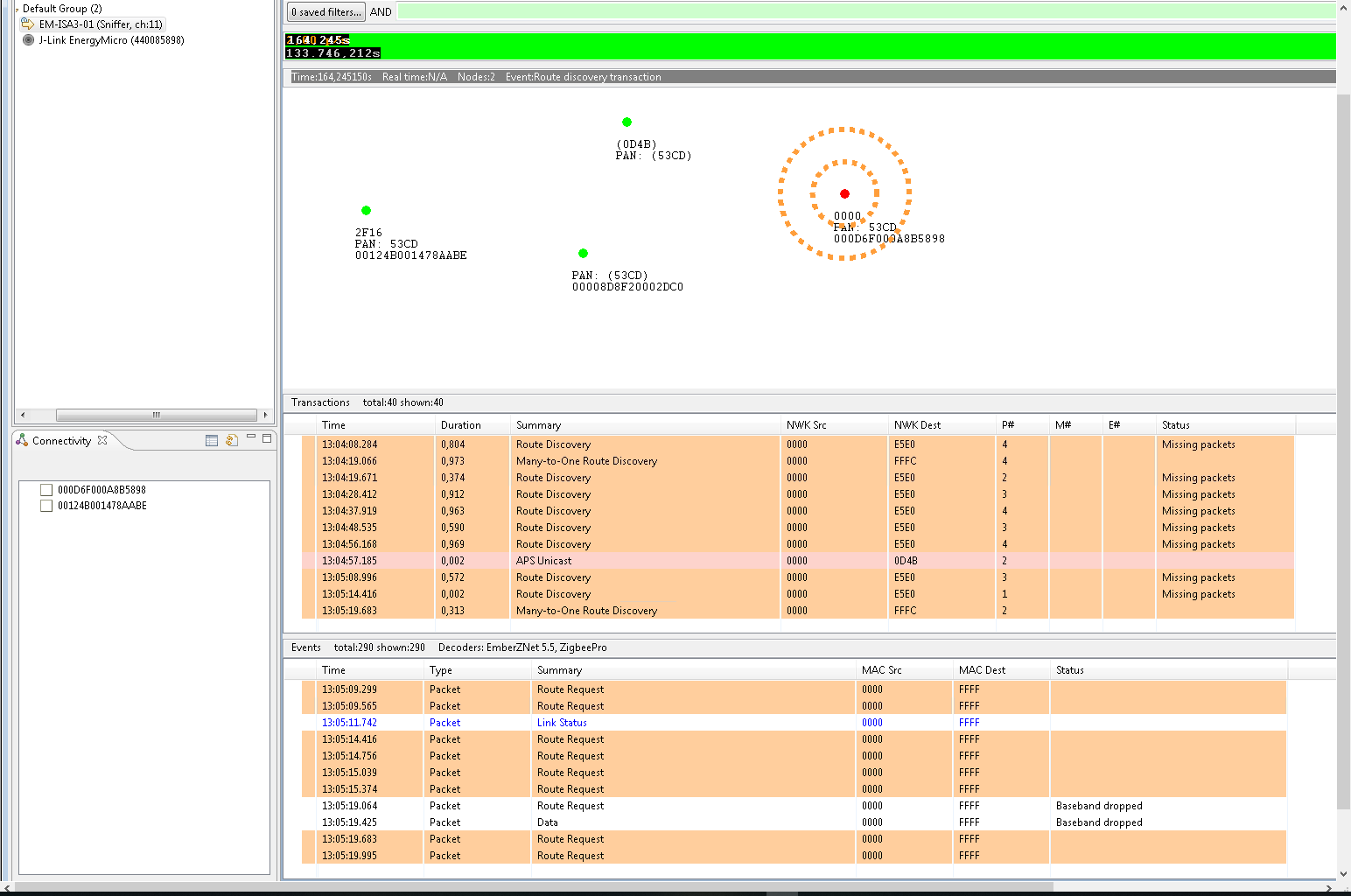

    when we now (hard)reset the controller we write 00124B001478AABE in the usercfg0, but when we try to join again then the node appears with the adddress: 00008D8F20002DC0.. (see screenshot below)
    we do not understand this behaviour..
    in our understanding the stack is initialized with the ieee address from the user0cfg right?
    is there a specific zigbeestack call where the address can be set?
    we just want to set the ieee address from the FCFG1. (the serialprint shows in both cases that the content of usercfg0 is ok).

  • Hey Daniel,
    I apologize as I continuously referred to how the application sets the IEEE extended address, however this is not the same decision as is made by the Z-Stack core. Inside stack_main of osaltasks.c, the primary address from the FCFG1 area is passed along (as pExtAddr) to zmain_ext_addr but is not the first selection. Z-Stack first checks to see if there is a valid entry inside NV memory. On a new image the NV items are empty so the primary address is used. However on restarts the NV memory is now populated and therefore those values are used instead. NV memory is from 0x1D000 to 0x1EFFF so I believe this is the behavior you are noticing. I've attempted to recreate the issue with the SampleSwitch project but have been unable to replicate the faulty NV memory behavior. Philipp mentioned changing configuration and bootloader settings, if you send linker files (cc26xx_app.icf/cc26xx_app.icf) and other relevant changes then we may be able to identify where the issue lies.  I'm also concerned about Philipp's changes to the ccfg.c file as it appears the project is not using the Z-Stack HA 1.2.2a RTOS release version (2.11)

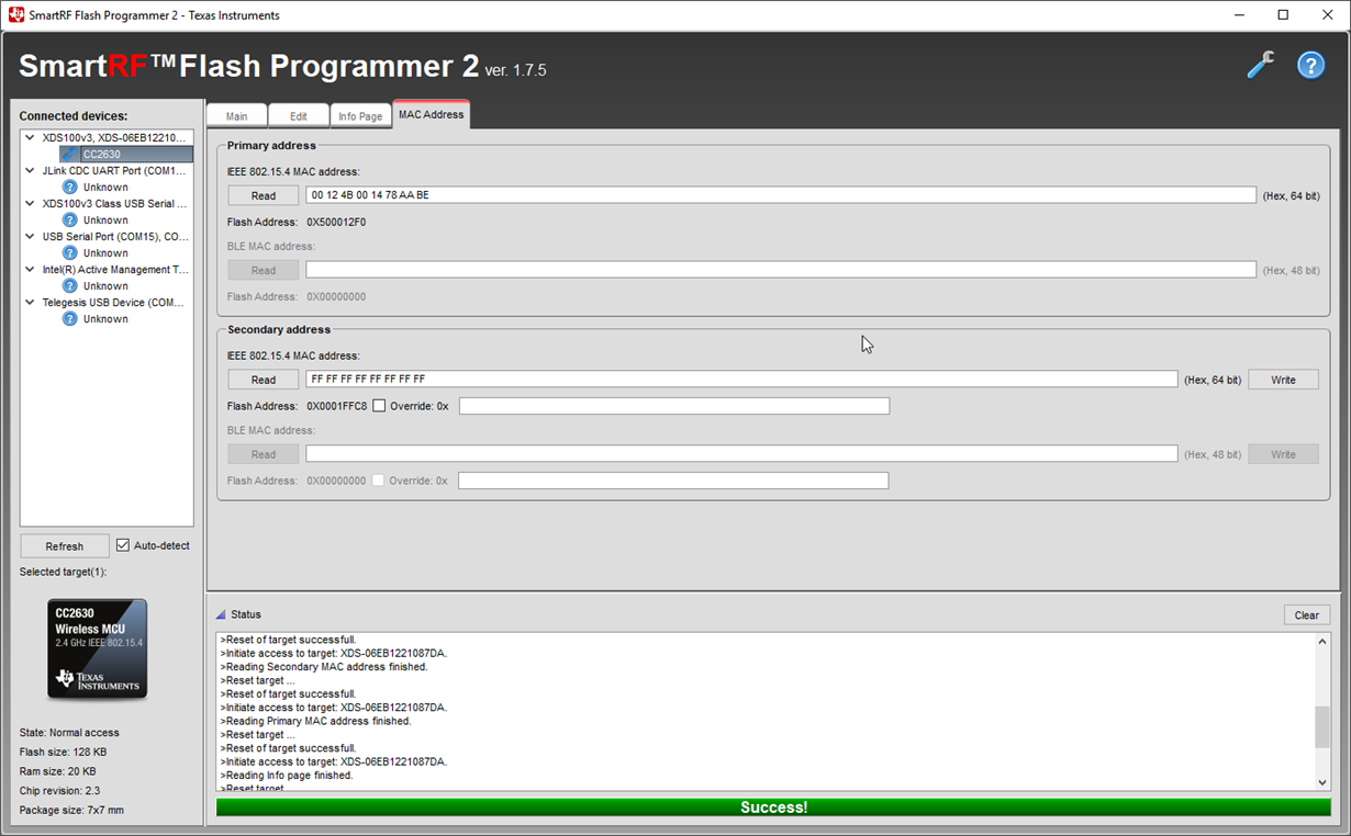

    We also inspect the flash of our cc26xx.. it seems that the IEEE Address is stored correctly the first time in the flash:
    so reading out is not correct for some reason.?
