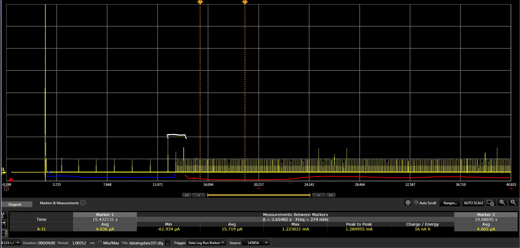

Im having a problem with the current consumption of CC2652 Sensor controller after it has finished its processing task,
The general idea is for the CC2652 to:
- sleep for x mins,
- wake up,
- configure and start the sensor
- Sensor controller task runs to completion
- Sensor controller is powered down to save current until the next time it is needed.
I seem to be able to power up and run the sensor controller correctly and i am able to start and restart the sensor controller task effectively.
However when we analyse the current consumption of the device we see that the current draw rises when we turn on the sensor controller, but it does not drop back down after we try and close the Sensor controller.
The Blue line represents the device sleeping,
the white line represents the SC being powered up and running the task and trying to shutdown
The redline represents that the SC continues to draw current forever
We are resetting the task structure and stopping the task like below..

  • One thought is that you have done something in the init code in the sensor controller code that should have been turned off in the termination code.
    The current plot looks a bit strange. Is it possible to zoom in some just after the white zone to see a bit more on how the current plot looks in detail?
    Do you have a minimum project that you can share (ideally both CCS and SCS code) that could run on a launchpad?

  • The scifStopTasksNbl should be all that is required for shutting down the SC. But what we thought about is if the SCE code opens up something that is not closed down in the termination code. Without knowing anything about your code it's unfortunately not possible to be more specific.

  • The LED PWM example uses timer2 and this example have this:
    // Disable the Timer 2 clock
    timer2SetClockSource(TIMER2_CLOCKSRC_NONE);
    timer2WaitForClockSource();
    in the termination code. Could you try this/ check this example as a reference?
