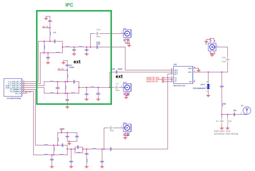

CC1352P: Reference design for cc1352P with JTI/MURATA Balun and switch
Case 1- 2.4 GHz: refer to LAUNCHXL-CC1352P-2 schematic.
Case 2- 868-928 MHz: refer to LAUNCHXL-CC1352P1 schematic.
Case 3- both 1 and 2: this will be released as an application note during Q3/Q4.
