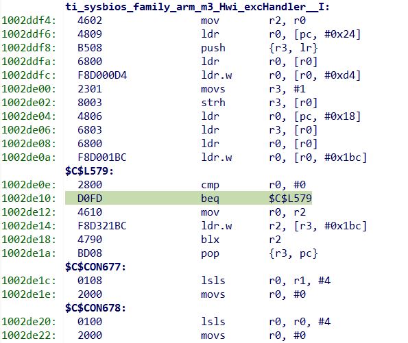

OK, we finally have our app building without errors after porting from simplelink_cc13x2_sdk_2_30_00_45 to simplelink_cc13x2_26x2_sdk_2_40_00_81.
It was previously running fine, but now its locking up on the first call to Task_create(). (we have multiple tasks)
Task_Params_init(&taskParams);
taskParams.stackSize = taskInfo->stacksize;
taskParams.stack = malloc(taskInfo->stacksize);
taskParams.priority = taskInfo->priority;
taskParams.arg0 = (UArg)tss;
tss->taskId = taskid;
tss->taskHandle = Task_create((Task_FuncPtr)taskInfo->threadStart, &taskParams, Error_IGNORE);  <---DOES NOT RETURN
Is there an easy way to debug these crashes?  From a disassembly view I see that it is hitting "ti_sysbios_family_arm_m3_Hwi_excHandler__I" and going into some sort of while(1) loop (see image below) .
We had a similar issue in the previous SDK, which used ICALL and we found that we needed to change ICALL_MAX_NUM_TASKS from 2 to 6.
Is there something similar now that requires that we increase the number of tasks allowed?

  • Hi Ryan,
    I was able to track down the problem.  It wasn't directly related to the Task_create(), but with OsalPort_registerTask() which was called during the task initialization.  The problem here was that the passed in semHandle was NULL.
    MyTask_ZstackId = OsalPort_registerTask(Task_self(), MyTaskTss->semHandle, &MyTask_events);
    Totally our fault, but still frustrating that the failure is a while(1) loop with no info available on what the actual problem was.
    We have run into similar issues several times now (it's a steep learning curve).  Is something available to better troubleshoot these types of issues?
    - Bill
