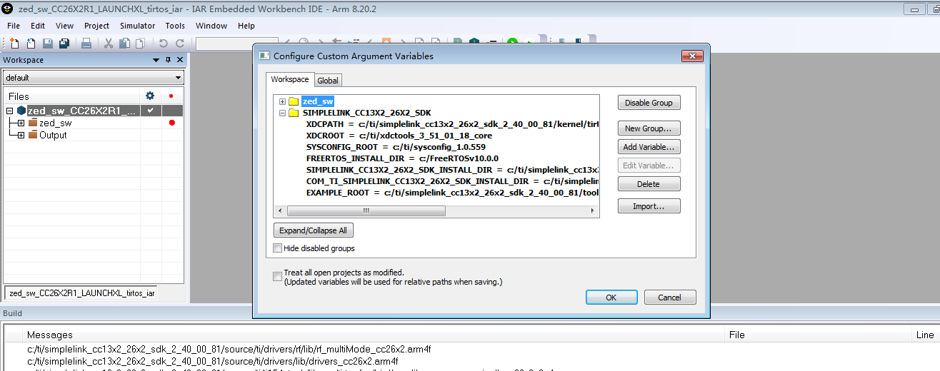

    there are no defined variable XDCPATH,XDCROOT and so on in *.custom_argvars file ,so IAR could found out any path to build project.
    I think TI LPRF team don't perform full test on Zstack.
  • Hi Dhanraj,
    Before starting to work with any of the TI Z-Stack projects in the SIMPLELINK-CC13X2-26X2-SDK using IAR, you need to load a set of variables that will be set for your current workspace.
    1. Select Tools -> Configure Custom Argument Variables
    2. Select the Global tab, then click Import
    3. Import the custom argvars from the SDK. The argvars are stored in a SIMPLELINK_CC13XX_CC26XX_SDK.custom_argvars file, which is located in the tools/iar directory of the SDK (<SDK_INSTALL_PATH>/tools/iar/SIMPLELINK_CC13XX_CC26XX_SDK.custom_argvars)
    4. You can open (<SDK_INSTALL_PATH>/tools/iar/SIMPLELINK_CC13XX_CC26XX_SDK.custom_argvars) in a text editor if you need to modify the default path argument variables
    5. Restart IAR

  • Import custom variable invalid,
  • Try placing your workspace inside of C:\ti\simplelink_cc13x2_26x2_sdk_2_40_00_81\tools\iar, this worked on my system without any build errors.
    Ryan
  • Encounter error again mentioned by Dhanraj even open zed_sw_CC26X2R1_LAUNCHXL_tirtos_iar.template.eww with IAR and save project file inside of C:\ti\simplelink_cc13x2_26x2_sdk_2_40_00_81\tools\iar,and restart IAR.
  • BUT why it ask to save workplace at different location?
  • this is a template of IAR project,only a template.
  • Dhanraj,
    If you import the Configure Custom Argument Variables before creating the project workspace then you will be able to choose your location without encountering any errors.
    Ryan
  • oops,I have been process this problem,the correct steps as following:
    1. open IAR application without any project
    2.import global custom variable with C:\ti\simplelink_cc13x2_26x2_sdk_2_40_00_81\tools\iar\SIMPLELINK_CC13X2_26X2_SDK.custom_argvars
    3. open existed IAR template project
    4. save *.eww file inside of C:\ti\simplelink_cc13x2_26x2_sdk_2_40_00_81\tools\iar directory
    5. rebuild project
  • yes I have tested the steps suggested by you @Ryan Brown. I am able to build the project.
