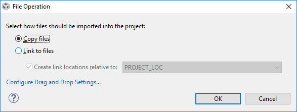

  • You can simply add the UARTCC26XX.c file to your project ("ADd Files...") and then:
    Do the changes you want to do, the re-compile.
    BR
    Siri
  • That works.
    Thanks.
