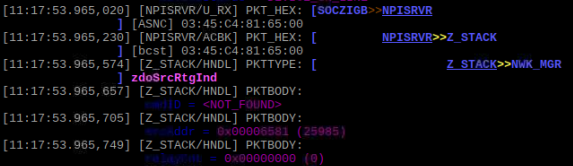

ZigBee 3.0 sensor to cloud gateway did not update report command data to gateway terminal application as well to node js application.
from the log it seems like nwkmgr is not sending report command data to the gateway application.

  • To replicate the issue you just have to send ZCL report command from any ZED/ZR .
    Report command will not appear on gateway terminal app(In older gateway it use to appear) as well on node is app

    We are using:
    1) Linux environment  = Raspbian stretch OS, running on Raspberry Pi.
    2) Ubiqua sniffer log = GwRptCmdBug.zip
    (change the file extension to .cubx Refer packet number 801 and 2556)
    3) gateway log =

    4) ./zigbeeHAgw script prints the below messages onto the console whenever the ZED/ZR sends report command (at periodic intervals).
