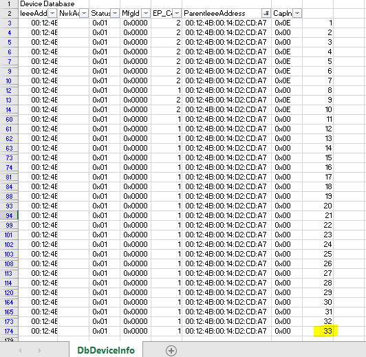

We have cc2652  and simple link sdk 2.30  based ZED.
cc2538-cc2592emk and Z-stack 3.0.2 based ZR.
cc2538-cc2592emk and Z-stack 3.0.2 based ZNP.
ZNP is connected to Raspberry pi 3 b+ via USB interface.
there are 125+ ZED and 10 routers in a network.
So we have observed that after a particular duration (5-7 days) gateway does not receive data(report command) consistently(> 75 % data loss ) or completely(100% no data)  from the routers and the ZED associated with routers.
But at the same time gateway receive the data from the ZED which associated directly to Gateway(coordinator-znp)
in this scenario when we reboot the gateway it starts behaving normally and receives data from all devices.
due to some restriction, we don't have sniffer log.
any clue for this situation.
