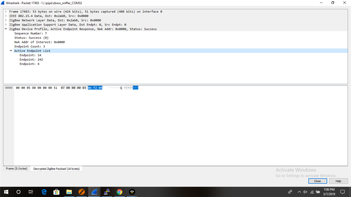

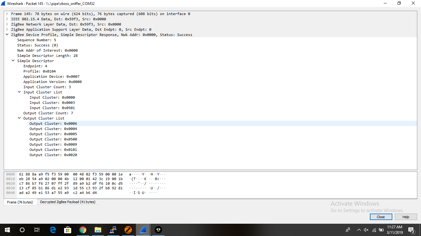

I have a use case where suppose one coordinator is running Z-stack 3.0 and other coordinator is running Z-Stack 1.0.
In this case my coordinator endpoint will change for my device, if i remove my device from coordinator with Z-Stack 1.0 and connect it to coordinator with Z-Stack 3.0.
I am looking to get primary endpoint from coordinator, how can i achieve that ?
