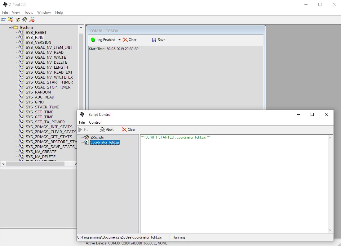

I'm trying to set up a Zigbee HA coordinator with TI Ztool and CC2531 USB dongle following the steps in this blog. Steps 1-3 go through normally, Ztool starts up and finds the cc2531 USB dongle without problem. Then I can send commands manually and receive responses.
The problem occurs when I try to execute the script coordinator_light.zjs (ZC_Com in the script was changed to COM30). Judging by the inscription in the status bar, script starts, but then nothing happens. There are no messages in the log windows, the COM30.html, Serial.html and Trace.log files created by the script are also empty.
What could it mean and how to run the scripts correctly in the program?

    I wrote a simple script to test:

    The result is the same, no messages in the logs.
  • I tried Z-Tool with scripts in Windows 7 x86 as a guest OS in VirtualBox (the host system is the same Windows 10 x64), and Z-Tool works as expected. So I have a problem with Z-Tool only in Windows 10.

  • I have already tried these scripts. The result is the same. The problem is that, most likely, any scripts do not run at all. Something is wrong in the interaction of Z-Tool script control with Windows 10 and I can not understand what exactly.
  • I can use the Z-Tool script on my Win 10 desktop without problem. I suggest you to try another Win 10 desktop and see if this is a specific issue on the specific Win 10 desktop.
  • Thanks for the advice. I would also like to know the opinion of the developers of the program. Probably, there are diagnostic procedures that will allow to establish the exact cause of the malfunction.
  • As I know, the only document for Z-Tool can be access from Z-Tool -> Help -> Contents.
  • It's working on my Windows 10 machine as well (same build as yours).
    Perhaps try reinstalling Z-Stack Home 1.2.2a.44539.

  • Z-Tool not running your script is likely independent of the ZNP; you can actually run your simple script (prints "TEST" ) without any ZNP connected to the PC.
    There may be some discrepancy at a lower level of Windows that we are not aware of.
    Please check on a different Windows 10 machine.
  • Trying to connect Z-Tool with CC2530, I came across the need to change the connection speed to 115200 and got an error (English translation):
    System.ArgumentException: The surrogate pair (0xD88B, 0xFFFF) is invalid. The top surrogate mark (0xD800 - 0xDBFF) must always be a pair with the bottom surrogate mark (0xDC00 - 0xDFFF).
    The next start Z-Tool leads to an error:
    System.IndexOutOfRangeException: The index was outside the bounds of the array.
    The investigation revealed that the Windows registry element HKEY_LOCAL_MACHINE\SOFTWARE\WOW6432Node\Texas Instruments\ZStack-Apps-1.2.0\Z-Tool 2.0\Settings\ComsInfo looks very strange, when I delete it, Z-Tool can be run without error.

  • Looks like there's some corruption in the Registry for Z-Tool (REG_MULTI_SZ) caused by the initial attempt to change the baudrate, which in turn causes Z-Tool to not open properly afterwards.
    This is likely a Windows 10/.NET issue.
    If you need to use Z-Tool, I would suggest just using it in the VM for now.
