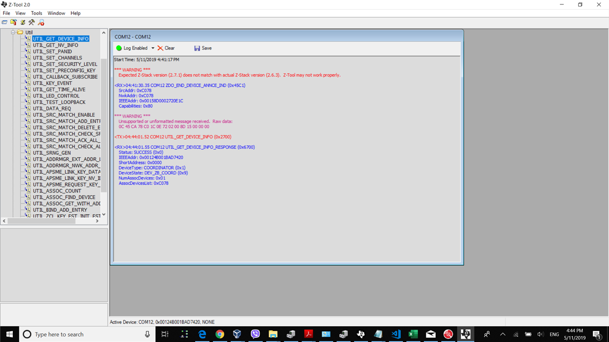

    i have flashed the CC2530 with SampleThermostat ZC and define all the MT functions also, i choose it because it already has the Temperature cluster defined and configured.  so it should work with 3rd party devices or at least i think. like the Aquara temperature sensor, i knew it because when i debbuged the message i found it uses the 0x0402 cluster ID as the SampleTemperatureSensor
    I have not received any RX data in ztool, you may refer to below snapshot.

  • referencing to the following post : e2e.ti.com/.../548578
    and perform the AF_REGISTER, CMD, I was finally able to get data in MT Function upon clicking on Aqura Switch.
    just one last question before marked as solution provided.
    Does the received data have standard zigbee pattern ? or does each device have it owns ?
    Data: .0.U.!.. (0x18, 0x30, 0x0A, 0x55, 0x00, 0x21, 0x01, 0x00)
