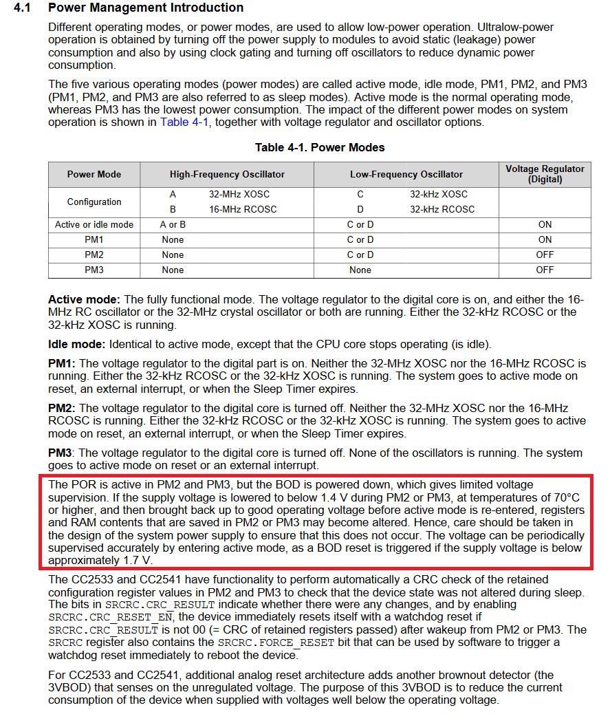

  • Hello TER,
    Thank you for your response. The reference can be found on the cc2530 document as you can see below in the red box (document : swru191f.pdf)

  • I only checked the datasheet, hence I didn't see the note.
    With regards to the note: Do you any operations during PM2/ PM3 that could be the cause of what you are seeing?

    We don't use any PM2 or PM3, i just quoted the text due to the temperature note (over 70 degrees). In other words the 1st question was: if the RAM can affected in specific temperature ranges and voltages can also be the flash?
