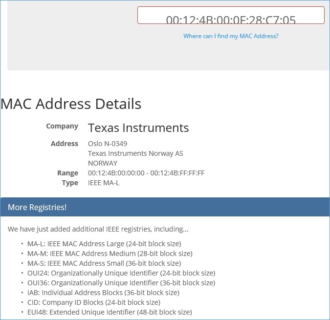

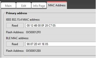

I checked the IEEE 802.15.4 Mac Address as shown below. (00:12:4B:00:0F:28:C7:05)
It is confirmed that the address is purchased by TI. (refer to below)

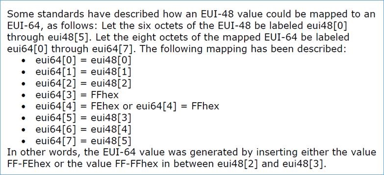

The two bytes in question are not completely random, calculated, or unique per device as far as I can tell. I'll try to find an expert at TI who knows more about this value but meanwhile I do not recommend making any assumptions or interpretations from it inside your application.
Ryan
The response to your questions is as follows:
1. No significance other than being part of the 40-bit unique device identifier part of the 64-bit address range
2. No
3. No
4. Yes

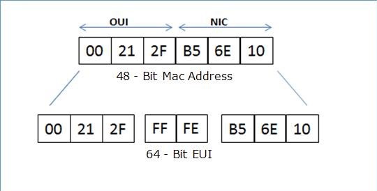

The 64 MAC address range is the entire 40 bit range for the 00:12:4B block, TI does not generate 64-bit addresses from a 48-bit MAC.
