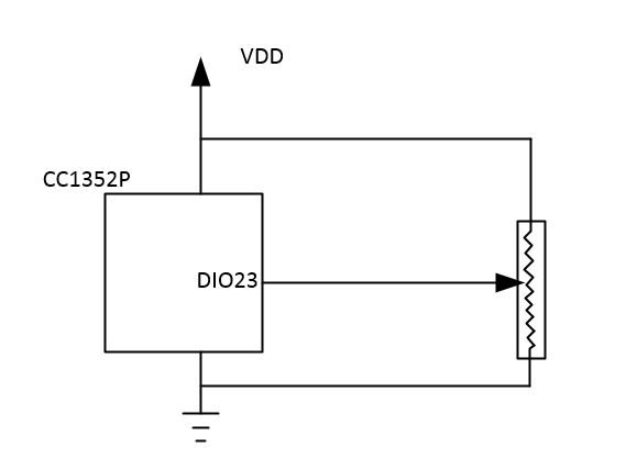

I'm trying to configure the ADC drivers to read a simple resistor divider ckt that is pulled up to Vdd. I want the counts to remain constant independent of the Vdd battery supply.
I thought that I could simply configure the adcCC26xxHWAttrs[] setting the .refSource = ADCCC26XX_VDDS_REFERENCE and then the counts returned from ADC_convert() would be the same no matter what the supply is.
I can't seem to find any documentation on how to configure the ADC Driver values, but here's what I have in my board file:

I'm getting the raw counts that I expect (+/- 0.5%) when the supply is 3.3vdc.  But when the voltage drops, the counts go up.
I've tried all combination settings for  .inputScalingEnabled  and .returnAdjustedVal and get the same fluctuation with supply.
What am I doing wrong?
