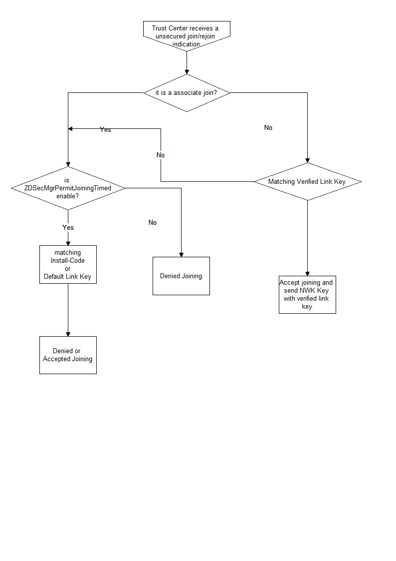

  • I want my coordinator to accept unsecured-rejoin device and re-transport new NKW key. How can I do to force my coordinator to stop sending Leave-Command to unsecured-rejoin device?
  • As I know, you cannot do this in Zigbee 3.0 Coordinator acting as trust center.
  • I have provided that set "zgAllowRejoins" to "TRUE", coordinator and router will not send leave-command to unsecured-rejoin child-node. But Trust Center will transport NWK key with Default-Link-Key encrypted. I think that it is better for Trust Center to transport NWK-Key to a unsecured-rejoin node with Verified-Link-Key encrypted.

    In zigbee 3.0 network, a joined Node could get a new Link-Key that is called "verified link key" from trust center. So when the end-device try to rejoin the network by unsecured-rejoin mode, if trust-center had stored its unique Link-key( generated by trust-center). This end device should be accepted by this network.
    1, set "zgAllowRejoins" into "TRUE" on router and coordinator, the parent node will not send NLME_Leave command to a unsecured-rejoin end-device.
    2, function "ZDSecMgrDeviceJoinDirect" in "zd_sec_mgr.c", there is some issue in it, fix it like this.
    ZStatus_t ZDSecMgrDeviceJoinDirect( ZDSecMgrDevice_t* device )
      ZStatus_t status;
      if(device->secure == FALSE)
      status = ZDSecMgrDeviceJoin( device );
      if ( status == ZSuccess )
      #if (ZG_BUILD_COORDINATOR_TYPE)
        //Add the device as joining device, if it did join unsecured
        if( (device->secure == FALSE) && !(device->devStatus & DEV_SEC_AUTH_TC_REJOIN_STATUS) )//fixed by luoyiming 2019-07-11
          bdb_TCAddJoiningDevice(NLME_GetShortAddr(),device->extAddr);//don't waiting verify link key for unsecured-rejoin
      #endif
  • This is the correct trust-center processing of my idea.
