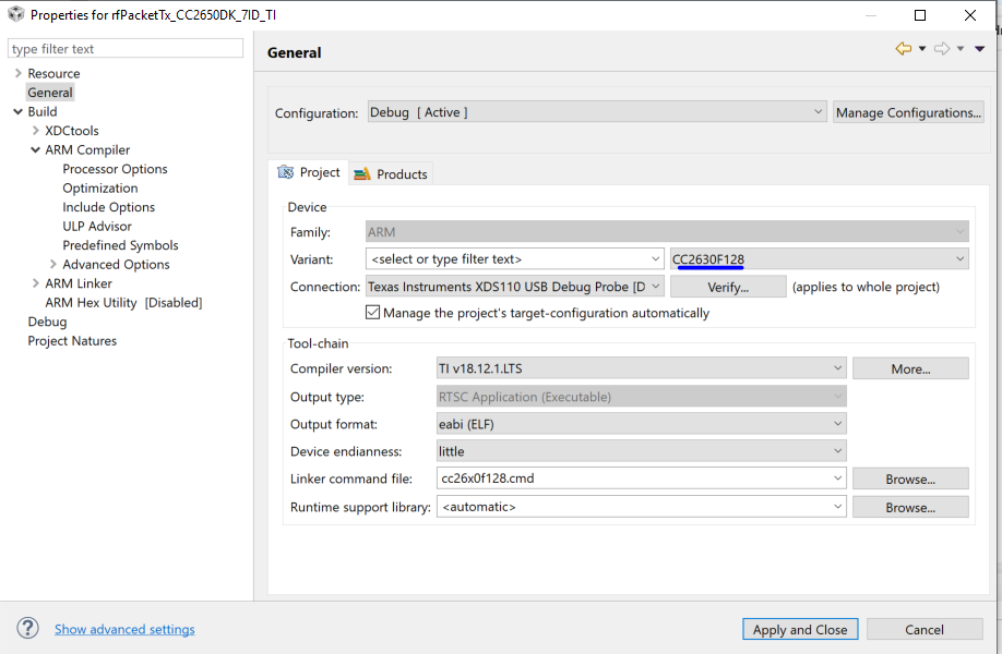

I get code in
C:\ti\tirtos_cc13xx_cc26xx_2_21_01_08\examples\IAR\CC2650DK_7ID\rfPacketTx (my chip is CC2630 7ID)
and do nothing change to load in cc2630, but not work , code is dead in this place
RF_postCmd(rfHandle, (RF_Op*)&RF_cmdFs, RF_PriorityNormal, NULL, 0);

2. as you asked , I change the choose to cc2630, the results i get is all the same.(not work)

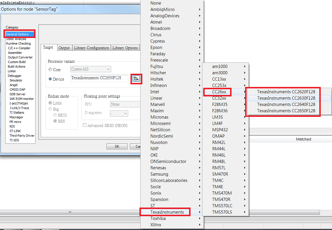

I am from Taiwan not China. Which IAR version do you use? Is it IAR for ARM 7.50? The IAR examples in tirtos_cc13xx_cc26xx_2_21_01_08 are built by IAR for ARM 7.50 so I suggest you to use it. By the way, I would suggest you to run this example on LAUNCHXL-CC2650 and make sure it work first.
Yes, I have some Zigbee products using CC2630 7ID and I don't have to change CPU setting from CC2650 to CC2630. The Z-Stack Home 1.2.2a examples can run on my CC2630 without problem.

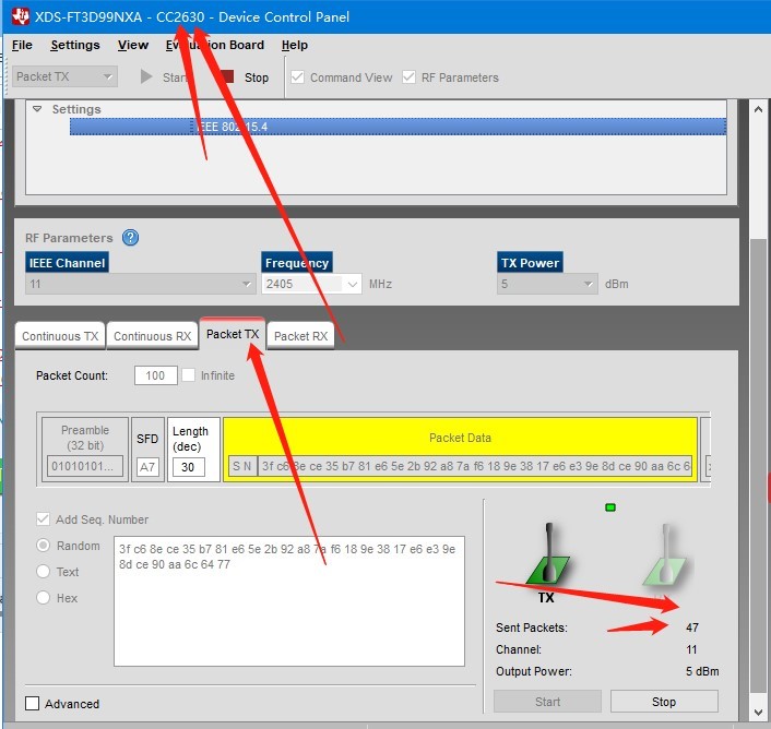

At frist I connect CC2650 and CC2630 with smartRF , one TX another RX . that all work fine.
And second, make CC2650 work in RF_MODE_PROPRIETARY_2_4 mode, CC2650 is fine;
set RF_MODE_IEEE_15_4 mode CC2650 work bad .
At last I export code from SmartRF 7 when CC2650 is work in RF_MODE_IEEE_15_4 ( set use smartRF) I find the the configuration is not the same to the example.
