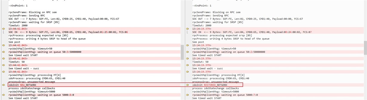

The compiled firmware, can communicate throw UART but I can`t pair any ZigBee device.
How can I compile exactly same firware as ZNP-Host-Framework\bin\cc2538-znp-120-uart-noflow-tclk.hex?
Best regards!
  • How do you setup ZNP to act as coordinator and form Zigbee network? Can you elaborate your steps?
    My steps are:
    1. Resetting ZNP
    2. Enter device type Coordinator
    3. Enter channel 13
    4. Set EndPoint 1
    5. Start binding
    We are using ZNP Host framework, and I will attach you a  detailed debug log from the framework.
    Thanks!

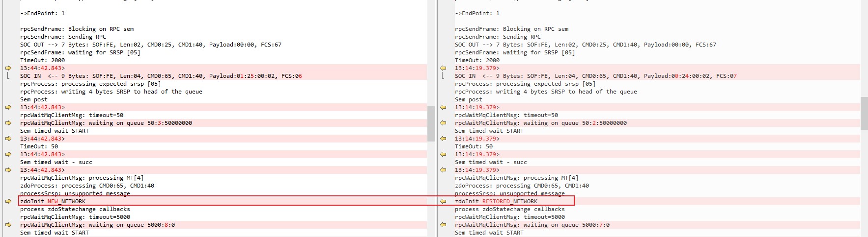

    ->EndPoint: 1
    rpcSendFrame: Blocking on RPC sem
    rpcSendFrame: Sending RPC
    SOC OUT --> 7 Bytes: SOF:FE, Len:02, CMD0:25, CMD1:40, Payload:00:00, FCS:67
    rpcSendFrame: waiting for SRSP [05]
    TimeOut: 2000
    13:14:19.379>
    SOC IN  <-- 9 Bytes: SOF:FE, Len:04, CMD0:65, CMD1:40, Payload:00:24:00:02, FCS:07
    rpcProcess: processing expected srsp [05]
    rpcProcess: writing 4 bytes SRSP to head of the queue
    Sem post
    13:14:19.379>
    rpcWaitMqClientMsg: timeout=50
    rpcWaitMqClientMsg: waiting on queue 50:2:50000000
    Sem timed wait START
    13:14:19.379>
    TimeOut: 50
    13:14:19.379>
    Sem timed wait - succ
    13:14:19.379>
    rpcWaitMqClientMsg: processing MT[4]
    zdoProcess: processing CMD0:65, CMD1:40
    processSrsp: unsupported message
    zdoInit RESTORED_NETWORK
    process zdoStatechange callbacks

    Now I sow one difference between work firmware and not working firmware. Work firmware make new network while not working framework make a Restored Network. I will attach you a picture of that.
