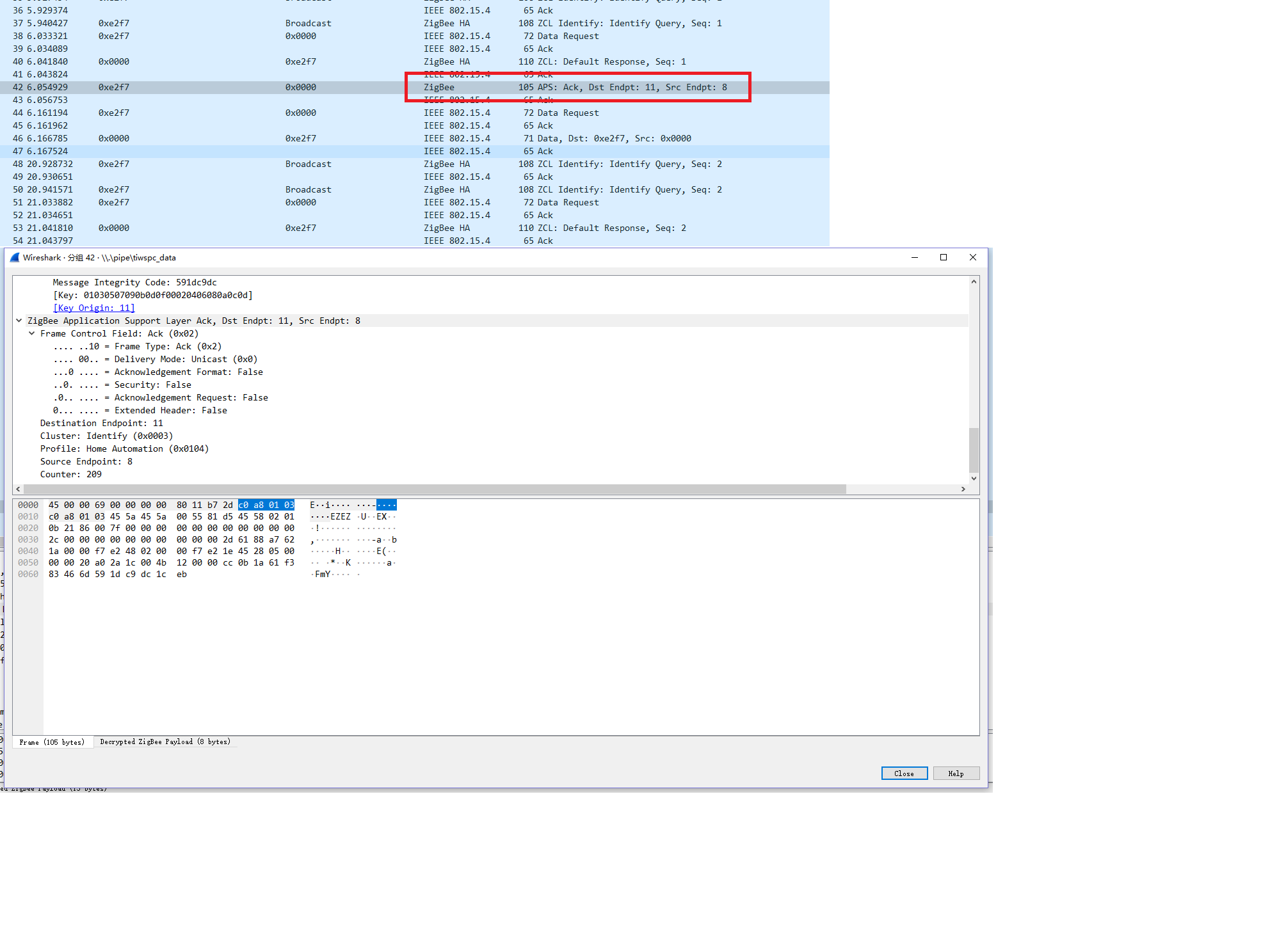

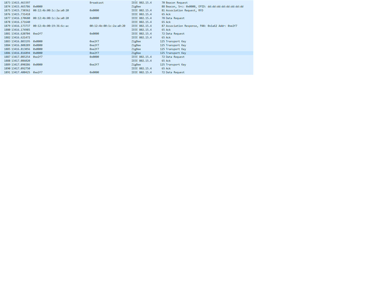

I'm testing the zclSampleTemperatureSensor in Z-stack 3.0.2.  This sample can join the network created by zigbee2mqtt. I could send the temperature to the sever correctly when it join/rejoin the network.
But I could NOT send the temperature when I press the key to change the temperature. I used the sniffer to monitor and I only got the data request per second. I added some test code as below.
if ( zclSampleTemperatureSensor_MeasuredValue < zclSampleTemperatureSensor_MaxMeasuredValue )
zclSampleTemperatureSensor_MeasuredValue = zclSampleTemperatureSensor_MeasuredValue + 100; // considering using whole number value
#ifdef BDB_REPORTING
status = bdb_RepChangedAttrValue(SAMPLETEMPERATURESENSOR_ENDPOINT, ZCL_CLUSTER_ID_MS_TEMPERATURE_MEASUREMENT, ATTRID_MS_TEMPERATURE_MEASURED_VALUE);
buff[0]='1';
buff[1]='S';
buff[2]=(status/100)+0x30;
buff[3]=((status%100)/10)+0x30;
buff[4]=(status%10)+0x30;
buff[5]=',';
status=zclSampleTemperatureSensor_MeasuredValue/100;
buff[6]=(status/100)+0x30;
buff[7]=((status%100)/10)+0x30;
buff[8]=(status%10)+0x30;
HalUARTWrite( HAL_UART_PORT_0, buff, 9);
#endif
I used the UART tool to monitor. I got the snap as below.  I think the BDB reporting was executed but nothing to send. I waited  20 min to make sure the report could be sent.
[14:06:59.254] UART0 output test1S000,021
[14:33:40.195] 1S000,022
[14:34:04.780] 1S000,023
[14:34:35.174] 1S000,024
[14:34:52.148] 1S000,025
[14:35:07.394] 1S000,026
Could someone help me to figure out this issue?  Thank you very much.
