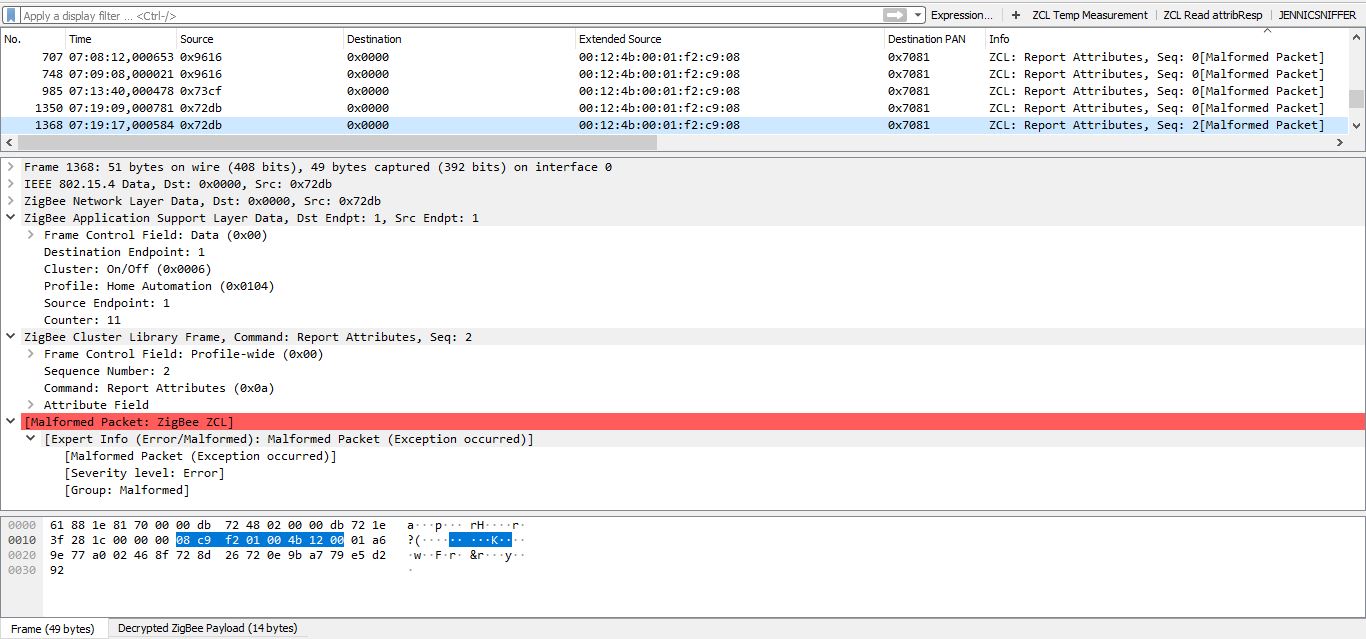

I´m working to implement the message report attribute according to ZCL foundation, using the "push" method attribute reporting, the devices themselves send reports when the attribute changes. In my case, I using the ZCL_CLUSTER_ID_GEN_ON_OFF, but when I check the message sent by device, over the air,  I saw that has malformed ZCL parameters. It can be seen on PIC attached.

I see in the ZigBee Cluster Library Quick Reference, as you see below, that All those parameters included in zcl_SendReportCMD are right but I cat in Wireshark, file attached, that has malformed parameters.
Does someone, please, give an idea of how to fix it?

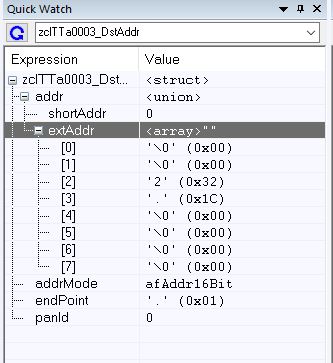

    I have configured as you told me, I have seen that when included _DstAddr=0 directly as you used the ZCL report attributes (0x0a) message is not sent. After it, I adopted as I did before &zclTTa0003_DstAddr. But still get no data type including, I believe that because it Wireshark decoded as malformed message/parameter.
    I also changed the ZCL parameter to Level Control and I observed the same behavior. As you see on Wireshark message attached.

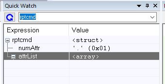

    You can see it in the PIC bellow, get from Quick Watch, that Attributes parameter filed is empty!
    I including my codes bellow used to send the last Report Attribute Message.
    // used at ZCL Reporting attribute
    	zclTTa0003_DstAddr.addrMode = (afAddrMode_t)Addr16Bit;
    	zclTTa0003_DstAddr.addr.shortAddr = 0;
    	zclTTa0003_DstAddr.endPoint=1; // DST Endpoint sent by Gateway

    	rptcmd.numAttr = 1;
    	rptcmd.attrList[0].attrID = ATTRID_ON_OFF; // Attribute ID of OnOff included in the Cluster Gen On/Off is 0 (ZigBee Cluster Library spec)
    	rptcmd.attrList[0].dataType = ZCL_DATATYPE_UINT8;
    	rptcmd.attrList[0].attrData = (uint8*)&zclTTa0003_OnOff;
