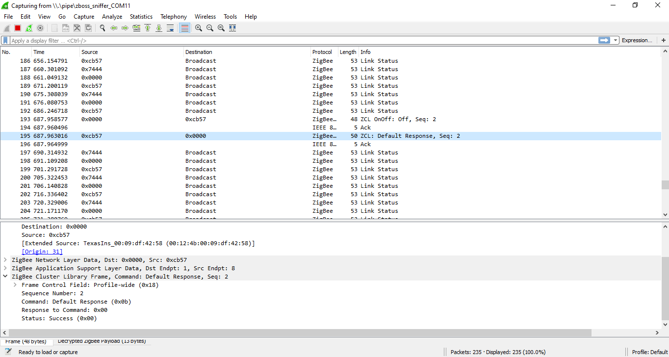

I am working on the CC2538 ZNP device. using the Zigbee linux gateway application & the znp host framework application too.
I have added a power socket application device in a network & then If I remove it using the Zigbee linux gateway application.
Logs over the zboss sniffer will be as follows.
ie. First it sends the remove comamnds to the respective device & then the device will broad cast the leave indication.

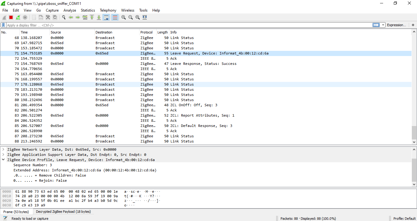

But If I have try the same functionalty on the znp host framework application by using ZDO_MGMT_LEAVE_REQ  command.
Device leave request will be sent to the device & successfull response will also received at the ZNP host framework application (ZNP device).
Device will also removed from the NV RAM. (If we check the ZB_GET_DEVICE_INFO command using param 1 to get devices that device will not listed)
But the device will not getting reaseted of getting the beacon mode, it stays as it is in its last state (On / Off).
the snifeer logs will be as follows.
