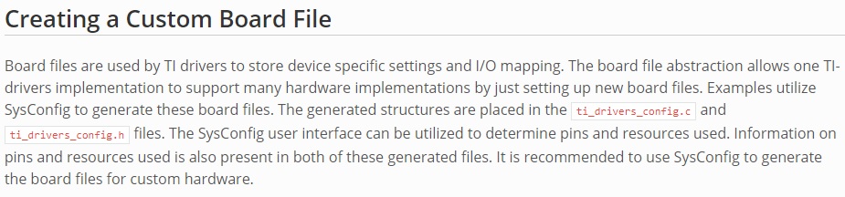

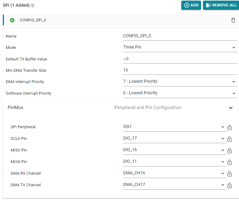

Hi all,
From your document, IO mapping is define in ti_drivers_config.x and can be generated by sysconfig. When I import a project into workspace. After edit ti_drivers_config.x and rebuild it, the ti_drivers_config.x re-generate by system(but not my expect). Please tell me how to change pin-define for our board. Thank you
