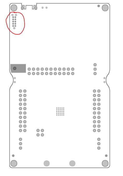

  • No. If you look at page 4 in the schematic found here:  the Tiva TDO pin is available on the debug interface found in the upper right corner if you hold the launchpad up side down. Look for this:
  • Excellent, thanks! I see ITDO is pin 6 on the footprint, which is a Tag Connect TC2050, which would be the top left pad when look at the physical board.
    I'll give it a shot and report back! :)
  • It worked!
