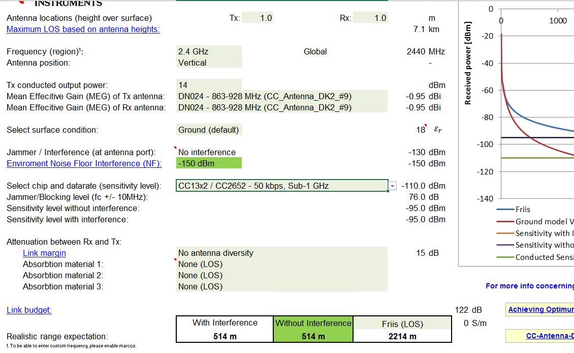

Hello, Community,
 I want to make a project on  LPSTK-CC1352R for that I  have following questions,
 1 If I used Zigbee mesh then what would be range between two CC1352R?
 2 If I used Thread mesh then what would be range between two CC1352R?
 3 If I just want to create mesh network using sub 1GHz is that feasible?
I need maximum range as well as mesh network what are other possibilities?
