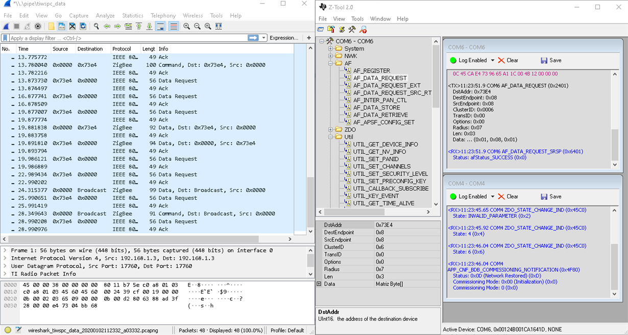

  • Thanks Ryan for your help, I understand what you are telling me, I would like to have some reference on how the packages are formed as you mentioned, I have read ZCL specification, but I cannot find clear examples to interact with the zc_sw/zc_light application, where could I see examples of frames for different applications)? Thanks.
  • I tried to execute the following command, but I don't see any change in the led of the end-device, I understand that the cluster for on/off is 0x0006, I don't know what I'm doing wrong
    <TX>10:28:33.43 COM6 AF_DATA_REQUEST (0x2401)
    DstAddr: 0x73E4
    DestEndpoint: 0x01
    SrcEndpoint: 0x08
    ClusterID: 0x0006
    TransID: 0x00
    Options: 0x00
    Radius: 0x00
    Len: 0x03
    Data: ... (0x01, 0x08, 0x01)
    <RX>10:28:33.43 COM6 AF_DATA_REQUEST_SRSP (0x6401)
    Status: afStatus_SUCCESS (0x0)
  • Shouldn't your DestEndpoint be 0x08 in accordance with your Simple Descriptor Response?  I also recommend that your Radius be greater than 0.  You should be providing sniffer logs to better understand what is happening over-the-air.

  • How often is the ZED polling?  Try using a TransID greater than 0 but I doubt this will make a difference.  I can only provide further assistance with a sniffer log.
    Ryan
  • I'm not sure how to know about polling of ZED, this happens when I execute the command
  • Each "Data Request" is a ZED poll which appears to be every three seconds, this is acceptable.  I am interested in the packet from the ZC at 19.881838 and the ZED response at 19.891810.  Please provide the sniffer file, not a screenshot.
    Ryan

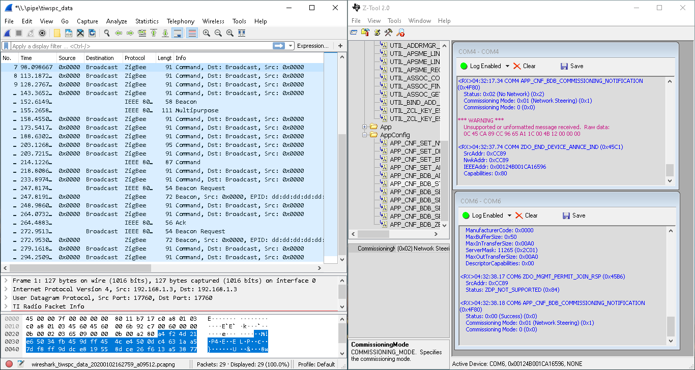

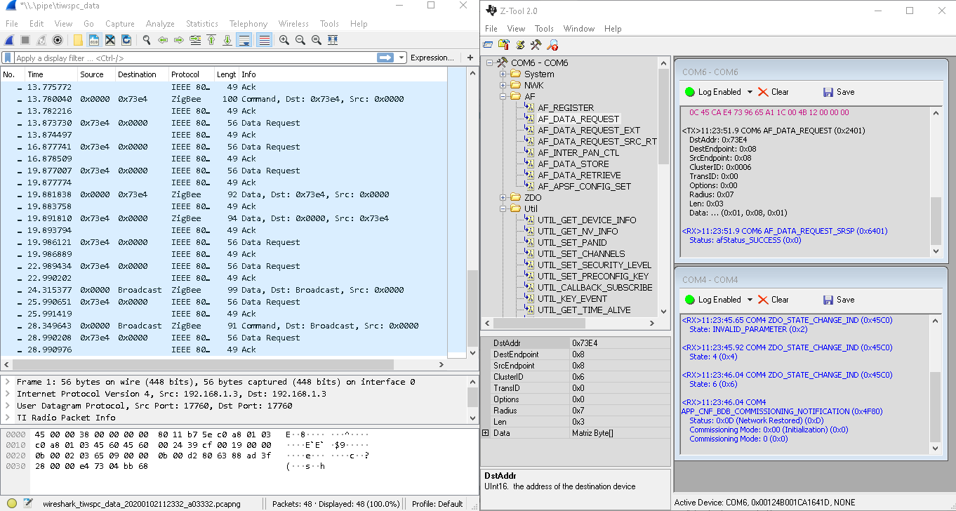

  • Ok, I understand, I attached the link of the sniffer file, I could not upload it here, with which other command of AF_DATA_REQUEST could check that some message arrives
  • The packets are encrypted, I need the NWK keys or a sniffer log including the ZED joining process.  We are basically attempting to determine whether the ZED returns a success or fail default response.
    Ryan
  • The key of Wireshark is 5a6967426565416c6c69616e63653039, Is it the key you need? Or how can I send you the sniffer log?
  • That's the Trust Center Link Key, I need the Network Key.  I can access and open the sniffer log, I'm just not able to read the encrypted packets.  Chances are you cannot decrypt them either without the device joining procedure.
    Ryan
  • how can i know this key?
  • Join a device to the network with the sniffer turned on so that it can pick up the ZC transport key packet.
    Ryan
  • I already did it, but I don't know exactly what is the package where the device comes in, this appears to me
  • Can you attach sniffer log instead of screenshot?
  • I'm not seeing a join inside the 29 packets provided in the last sniffer log, just beacon requests/responses and link status messages.  This does not provide any assistance with the issue.
    If you cannot provide a decrypted sniffer log then perhaps you can debug the ZED for the incoming ZCL message since we know that the packet makes it to the end node given that a response is returned.
    Ryan
