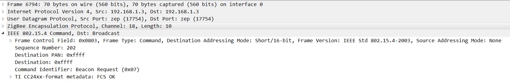

I never thought of this before (Kim did :), but the 802.4.15 Beacon Request contains a Destination PAN field.  Since we are specifying the PAN for a joining FFD to use, should/could this field be set to that value?  Would that then cause only routers on that PAN to respond?  If this is true, that would greatly reduce traffic for an FFD looking to join a PAN when there are many PANs on that same channel.  It would also help us identify rouge devices.

  • In addition to Ammar's reply, the 15.4 spec mandates that the destination PANID be 0xFFFF for Beacon Requests.

    We're actually using the zstack and not the ti154stack. We're also looking to change the destination PANID in the Beacon Request.  It looks like the BeaconReq is being built in ApiMac_mlmeScanReq(), which isn't available.
    Toby,
    I didn't see the mandate for the destination PANID to be 0xFFFF, but I guessed that that may be the case.
    Regardless, is there a place in the zstack where we could attempt to override this with a specific PANID as an experiment?  Or is it buried in some mac api too?
  • Bill,
    Per IEEE Std 802.15.4-2015:
    Changing this field would lead to undefined behavior for both the sender and any potential receiver, and thus the logic which sets this field is inside one of the MAC libraries.
