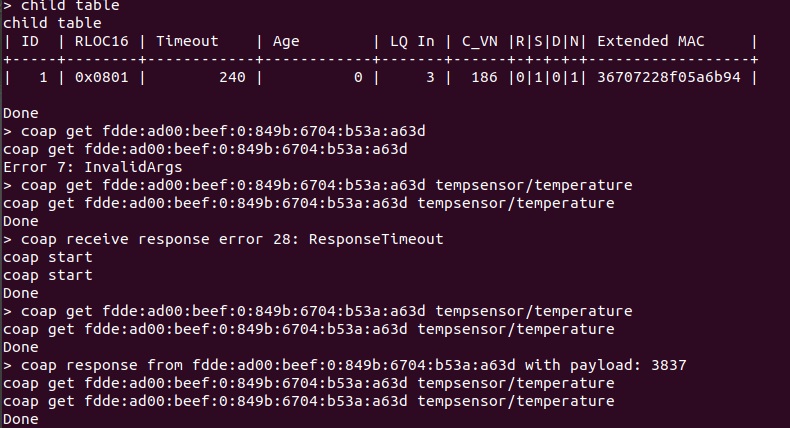

I followed below link to create thread border router in linux-host (cc1352r).
https://hpssjellis.github.io/particle.io-photon-high-school-robotics/a17-particle-mesh/openthread/install-openthread.html
NCP device is end-device, Thread-cli example working as leader.Temp sensor is joiner device in my thread network.
was that method right to create thread network?
Now, I want to test  thread mesh network demo, provide me a way to test that.
Now for OTA  server, I followed this README_TTOAD.html and successfully created "ttoad-server".
In my project there is no meshcop folder as in shown above image.
Do we have any other cmd to start OTA download?
