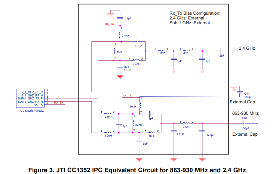

1) is there any reference design available using cc2652p  for +5dbm and +20dbm output??
2) Also can we use  murata balun LFB182G45BG5D920 or JTI balun 2450BM14G0011 for +5dbm output.
3) Is there any compatible balun available for +20dbm section.
4) Also can we use internal bias configuration for +5dbm and leave RX_TX pin unconnected.
