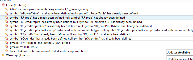

I am having an issue integrating the DMM with ZStack and Easylink Subghz.
At first I tried including the Easylink Libaries in the Zstack genericapp example and tried to compile it, but then I got an error saying that I got variable conflicts
In my understanding they are both using the ti_radio_config.c/h which causes the conflict.
Is there a way to integrate ZStack and Easylink together for DMM? Our requirements doesn't need to make ZStack and Subghz work concurrently.

  • Hi M-W,
    Thank you for your response. As I have attached here are the variables that got conflict.
    Would it be okay to rename this variables? Will it still work the same for ZStack or Easylink library?
  • Hi Jonathan,
    Those errors does not say much of which files are conflicting. We could assume the Zstack uses these "default" structure names already. You could possibly change the Easylink version but you would also need to change all Easylink references to the structures to match the new name. An alternative is to not use Easylink but work directly with the RF driver, you could then choose to export settings with another name prefix.

  • Hi M-W
    I have resolved the variable conflicts by adding a prefix in those variables. EasyLink made it easy via sysconfig.
