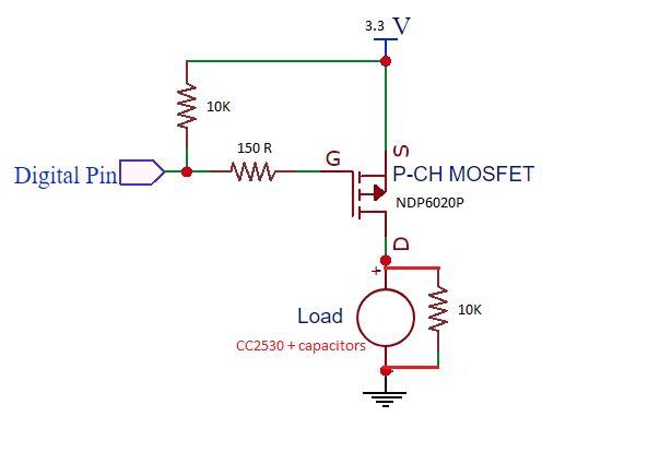

My question is in relation to a CC2530 in a low power application using Z-stack home 1.2.2a. I'm using serial UART with the CC2530 ZNP, and this won't interrupt the device from low power PM2 and PM3 mode, only SPI is supported. I know I could possibly program an interrupt, but I don't have software experience so I thought one option would be use a mosfet as a switch to power off the radio.
I have used a P-channel mosfet to switch the active to the CC2530 in a prototype and put a 10K resistor in parallel to discharge the capacitors when the mosfet is switched off. My circuit and software function fine, but I was wondering if there is any general advice you can give me about what I should be wary about when using this circuit. Should I put the RESET pin low prior to cutting power? I have attached a basic schematic of my mosfet circuit.
Alternatively if I could receive help with programming an interrupt that would be good because it will require less materials.  I have previously programmed an interrupt for another project using the samplelight example, but there were already easy to follow examples.
The z-stack znp project has the same Hal_key.c file which I know how to program an interrupt, but I'm not sure where to call the interrupt to wake and sleep the device?  I'm using the standard ZNP Z-stack home 1.2.2a which has P0_1 and P2_0 (joystick) as interrupts but I can't see any calls to the interrupts and grounding these pins does not trigger an interrupt.

  • Hi Quinn,
    I can assist with the pin interrupt programming.  The ZNP already has all key configuration functions but will not execute them unless HAL_KEY is set to TRUE inside the hal_board_cfg.h file.  All Z-Stack projects use polling for key processing instead of interrupts, changing this will require setting HAL_KeyIntEnable to true in hal_key.c and using HalKeyConfig(HAL_KEY_INTERRUPT_ENABLE, OnBoard_KeyCallback); inside InitBoard from the OnBoard.c file.  Please note that sleepy ZEDs typically enter PM2 to send data requests at a determined POLL_RATE, whereas ZR/ZC devices must always be active to route packets.  Entering PM3 will disallow the servicing of UART commands that are received during this time.
    Ryan
