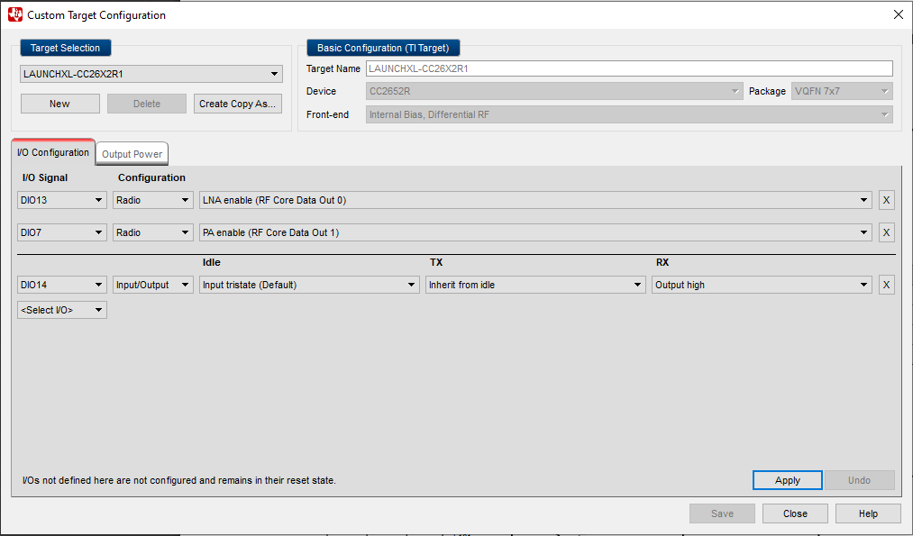

I am trying to  configure the RF Core for my external amplifier CC2592 on a CC2652 custom board and was wondering if there is any option to configure the RF Core Pins in SysConfig similar to how it is done in Smart RF Studio.
I have (attached snap from Target Config of Smart RF Studio)
DIO13 - LNA
DIO7 - PA
DIO14- HGM
Akhilesh
Target Config

    1. Based on the CC2652 TRM section "13.3.3 Control External LNA/PA (Range Extender) With I/Os", it seems your configuration should be fine.
    Please also note that there are DIOs which are configured by the Z-Stack examples as well.
    For example, in the ti_drivers_config.h file (generated by SysConfig), DIO13 is used by BTN-1 (CONFIG_PIN_BTN1). This may be overwriting the configuration you've performed for the RFC signals.

    I copied the generated files into the application and disabled the .sysconfig file so that they wouldnt get overwritten.
    However I noticed that I still needed to Initialize the pins, so had to make and update to the ti_drivers_config.c file to include the Pins used by the RF Core.
    I was able to observe amplified Tx after that.  Thank you for the assistance
