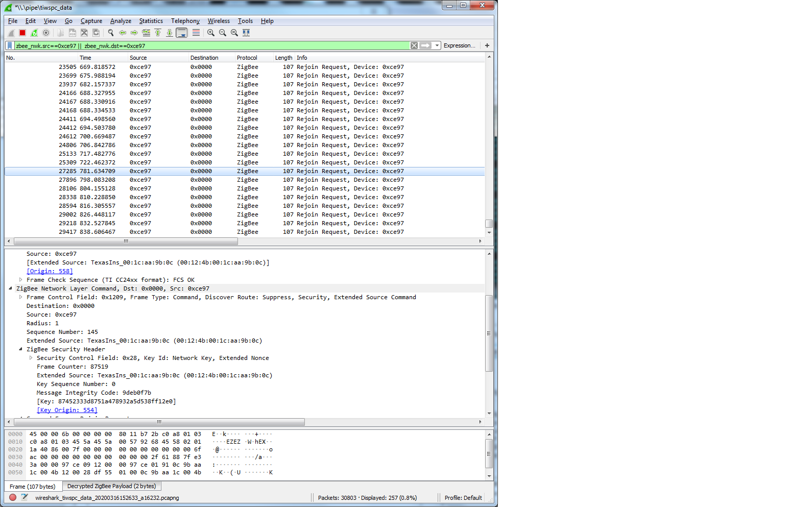

Hi Ti Team,
We observed that our ZED with  source addr=0xce97 cannot  consistently re-join after power cycle.
 It can re-join after several power cycles or several re-join retries.

  • Hi Walter,
    Do you observe the following behavior with other ZEDs? How many ZEDs are in the network?
    Would it be possible for you to try to use a different device as the coordinator instead of the CC2538 and see if the same behavior occurs?
    Marlyn
  • Hi Marlyn,
    Same behavior with other ZEDs. Even if 1 ZED only this problem persists.
    We do not have other coordinator and also want to fix our own cc2538 issues.

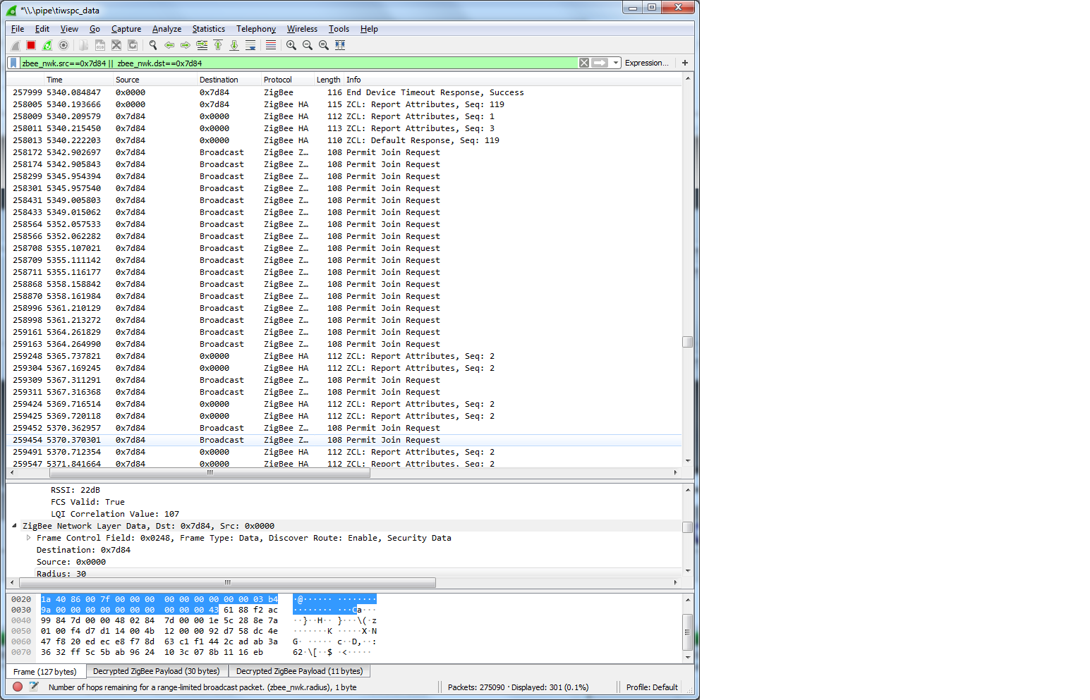

    There is another issue where one device keeps sending Permit Join Request. Any explanation for this? Please check the snapshot and the sniffer log.
     https://e2e.ti.com/cfs-file/__key/communityserver-discussions-components-files/158/some-device-always-send-permit-join-request-source_3D00_7d84.png.pcapng.7zRegards,
    Walter
  • Walter,
    Could you please check the relevant association table/s when a ZED tries to rejoin to see if it is still associated?
    Have you reset and re-flashed the device?

    Please provide smaller or partial sniffer logs as these are very large and therefore difficult to filter through.  Based on the inhospitable channel, with the large number of devices and networks communication, it becomes difficult for the ZC to send MAC ACKs or Rejoin Responses to the ZED.  Focus on debugging your ZC.
    Regarding the Permit Join Requests, the ZED retries if not receiving a MAC ACK but otherwise appears to be transmitting on a 3-second timer.
    Ryan
  • Hi Ryan,
    Rejoin now OK after adding this:
    1. We increased the NWK_FRAMECOUNTER_CHANGES_RESTORE_DELTA  from 250 to 1000 based from https://e2e.ti.com/support/wireless-connectivity/zigbee-and-thread/f/158/p/890135/3291505#3291505
    2.  We added this -- from https://e2e.ti.com/support/wireless-connectivity/zigbee-and-thread/f/158/p/808476/3040533
    1

    Let me know if these changes are OK.
    Walter
  • Yes, these changes are fine.  Thanks for providing your solution.
